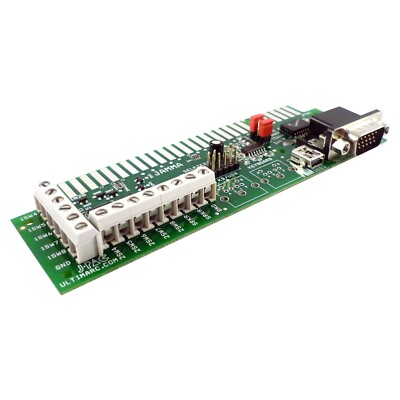

Just looked and this will work and is the best option looking at it. Cheap too !

want to ask this, does it matter what hz the GPU is running at or does this just handle it all?
I doesn't do anything to video signals, except amplify RGB. You need to configure the PC to output correct video for the monitor you're hooking it up to, using crt_emu driver or whatever.
