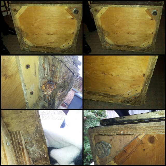

I am a little unsure how to approach the repairs to the base of my cabinet. The wood is damaged and rotten in parts and would appreciate some help or guidance. I was told to use wood filler but I'm not sure where to start. I have some wood filler, but was looking at using this too: http://www.wilko.com/fillers+sealants/ronseal-wet-rot-wood-hardener-250ml/invt/0150116?VBMST=wood%20rot
Here's a series of images that hopefully will help.
Thanks in advance,
Rory
Dex-Jay
375CR
Were it mine I'd...
1 let it dry out (if damp)
2 Knock off anything really loose with abrasives.
3 Use wood stabilising solution (brush that on)
4 If anything is really mushy (like some of those traingular pieces look) replace them.
5 Glue, screw, staple!
6 Fill to shape.
Sounds easy!
The plywood base looks OK so you shouldn't need to replace that, but even if you did just replace like for like - Same timber and same width.
