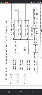

7,366CR
Q451, Q452, Q453 on the MS8-26SG) can cause colour issues, such as one colour disappearing or bleeding.
The above is AI …🫣
Só I thought I would
Look at a schimatic
Ms8 -26sg
img_3623-jpeg.44224
Red on neck card goes through Q301 , 302,303& 304
