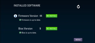

Bought and Ice Cold Beer remake that was having some issues. Here's how i got it to work nicely.
1) Updated bios (v9) and firmware (v44) to latest versions using the mobile app.
