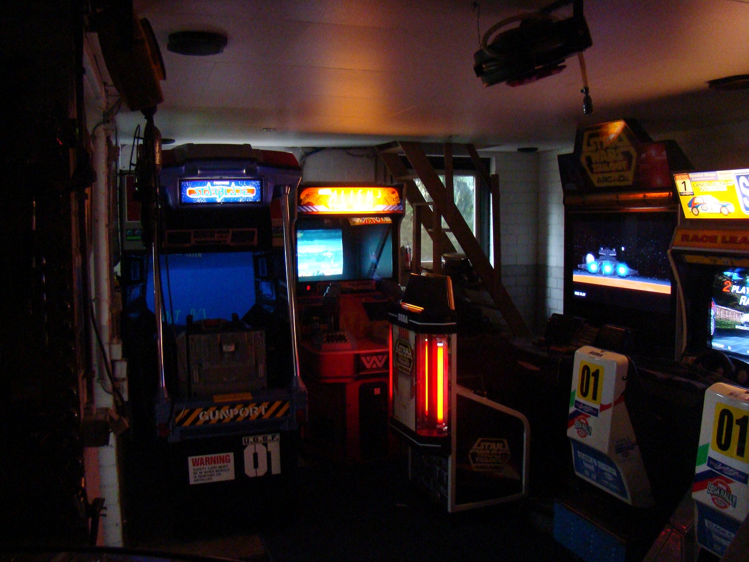

got my starblade in last week
cleaned it up andinstalled a fresh 25 inch nanao
i like it cool machine, with the parabolic mirror,but weighs a ton
