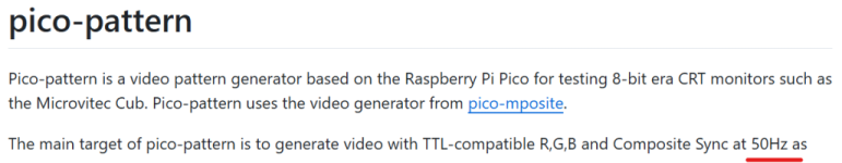

Very cheap and easy pattern generator using an raspberry Pi pico.
https://github.com/sharpie7/pico-pattern
The compiled file on github is for the pimoroni Pico. Attached you can find an compiled uf2 file for the bare pico and use GPIO 10 for the push button (active low).
GPIO3 - RED
GPIO4 - GREEN
GPIO5 - BLUE
GPIO6 - Sync
GPIO10 - Button
I used an old powerbank to make it portable. Project on Github is not mine, I just found it, built it and share it. Have fun.

I am from the United States and we use 60Hz. Is there a version of this program that can provide 60Hz? If not, is there an easy way to modify the program for 60Hz?
Arcade monitors and games are pretty much all 60Hz, so the test pattern generators are all 60Hz rather than 50.

So you are saying that the pico-pattern generator runs at 50hz and it works on your 60hz monitor? If so, then maybe I will give it a try on mine to see if it works well enough.
You would need to change the frequency of the DMA channels in cvideo.h
#define piofreq_0 5.25f // Clock frequence of state machine for PIO handling sync
#define piofreq_1_256 7.00f // Clock frequency of state machine for PIO handling pixel data at various resolutions
#define piofreq_1_320 5.60f
#define piofreq_1_640 2.80f
If those are 50hz timings you would need to make them all 50/60 times the current values and it should kick out 60 frames per second.
#define piofreq_0 4.375f // Clock frequence of state machine for PIO handling sync
#define piofreq_1_256 5.83f // Clock frequency of state machine for PIO handling pixel data at various resolutions
#define piofreq_1_320 4.66667f
#define piofreq_1_640 2.33333f
Totally untested, just following mathematic logic ...
