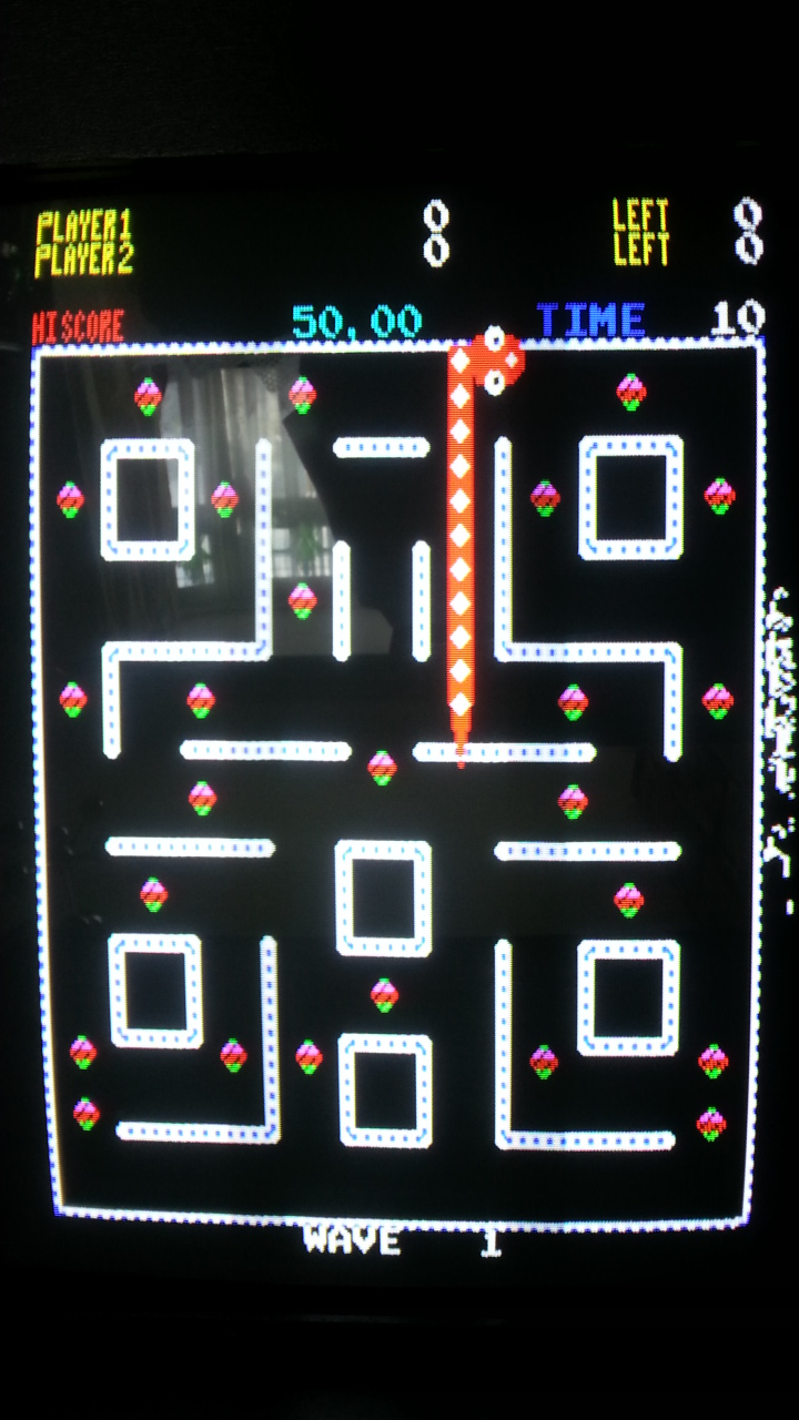

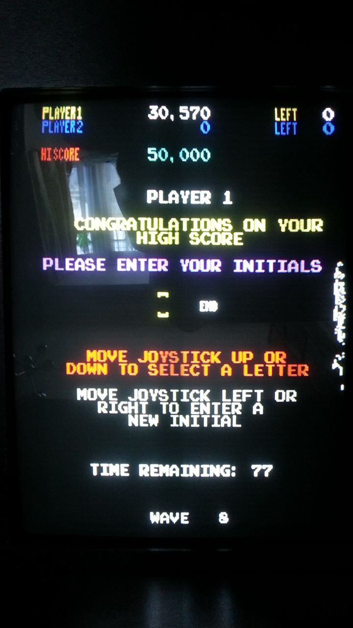

Put an adapter together thanks to Garry's help
this appears to be a taito licensed version
Got some issues with some roms (tile collisions and tile issues when chips pressed)and funky sync on right hand side where credits displayed.
Picture upside down in my cab managed to get 30570 with controls reversed!
