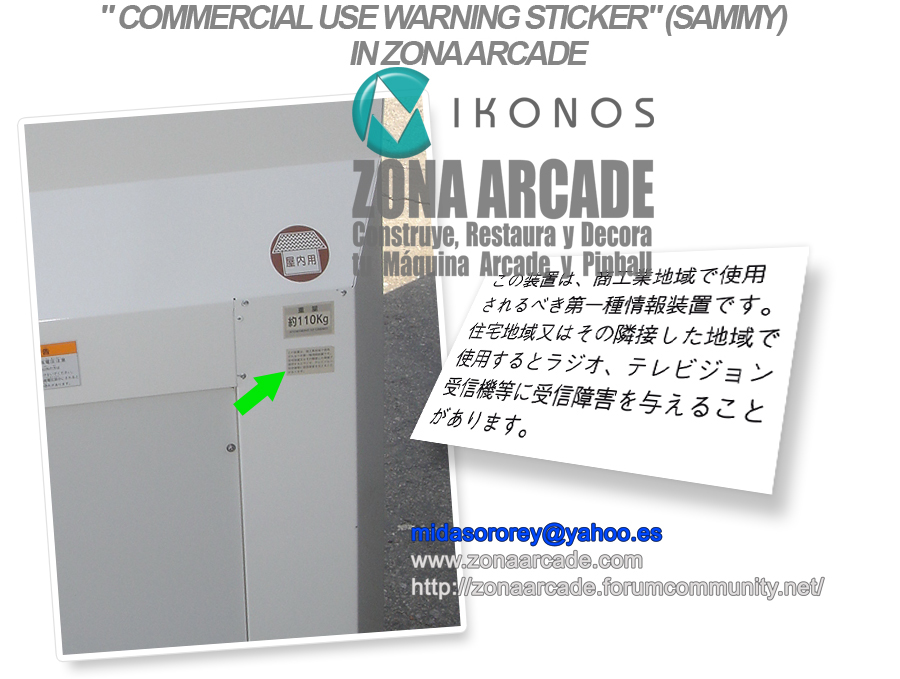

Mikonos11
92CR
The decal you see destroyed is the "Commercial Use Warning Sticker" (TAITO).
"Commercial Use Warning Sticker" (SAMMY) arcade file in Zona Arcade.
Commercial-Use-Warning-Sticker-Mikonos1
Regarding the weight decal, it appears to be a variant of the one I have, with some areas shaded, or it may simply be damaged.
Although I haven't spent much time restoring all the material I have from this arcade cabinet, a few years ago I created a compilation thread to show everything I have (everything you see is not everything I have). This thread will help you find out where certain decals are located.
https://zonaarcade.forumcommunity.net/?t=63024441#entry465400540
A little secret: some decals are the same as those on the Egret II and Egret 3 cabinets.
Cheers!
