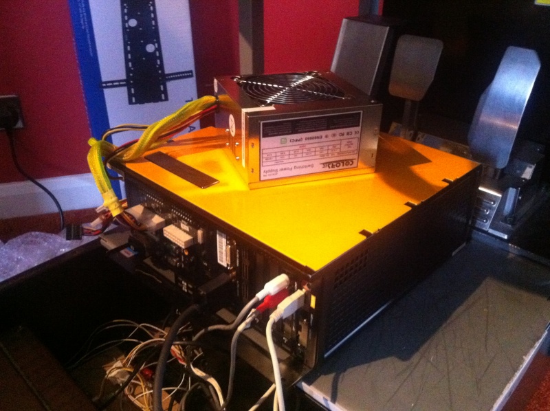

First of all I hooked it all up to see if the thing would actually work with the JVS I/O that is in the ID cabs, good news it does.

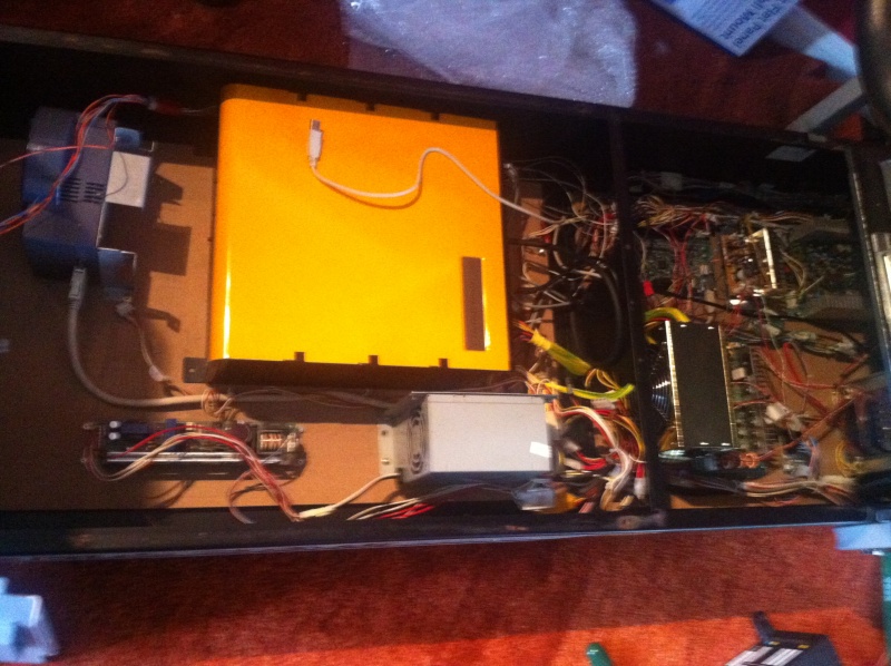

I used a 500W PC power supply to feed the Lindbergh so had to squeeze that in as well, but in the end it all fits, I have since cleaned up the messy wiring that was a rats next when this picture was taken.
The controls map very well with an ID/OR2 cab, shifter points & view buttons all map straight through but there is an extra button which is required to play the game.
BOOST !!
I generally use the credit button on the M3 Panel as my "extra button" this works as the item throw button in MKGP so I ran a new line from here to pin 28 on the JVS and boost was all up and running.
The final result was this..

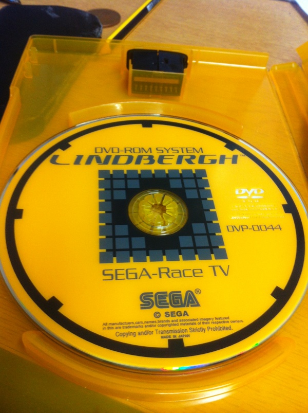

No you don't need to install the DVD every time, in fact the DVD drive for the Lindbergh is an extra and its not an internal drive, the games get loaded onto the internal hard drive.
I used an external DVD to install which took a little while to complete and then boot time on power on is about 5 mins, it goes through loads of checks etc to make sure its all working.
