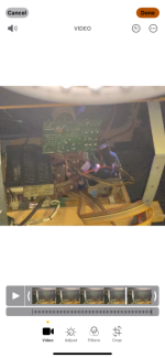

Hi all, new to the forum and hoping for any help, my mame cabinet houses a 28” monitor with a Hantarex dual sync chassis which isn’t starting up, just sparks on top of line output transformer when powered on, I think I can hear the tube fire up but no image. About 10 years ago I sent this chassis off to a guy called Grant but don’t know how to find him, or whether he still repairs them, I’m willing and able to discharge monitor etc and can solder and use a meter. I’m just not sure where to start. Any help appreciated. ThanksIMG_1790.png

Hi Grant, I got a new 7375 fly back from teckno service, I’ve just installed it correctly as far as I can tell but the monitor does this.
On power up the screen comes on after say 3 seconds with a bright white screen it stays on for like 10 seconds then I can hear a faint click as the screen goes black. The neck of the tube is glowing even after it shuts down. Really at a loss now and feeling disappointed 😞 any advice welcome

If I remember correctly the Polo 2 get's its heater voltage directly from the power supply rather than the flyback (which is where most chassis get the heater voltage from). Turn the screen control on the flyback down if it isn't already. Check that the resistor R40 on the neckboard isn't open circuit, it's a 10ohm flame proof type. These can go open circuit very easily from static when handling the neckboard. Otherwsie check the poly caps behind the flyback if you've not done already.

Thanks for this I will try to check these things
