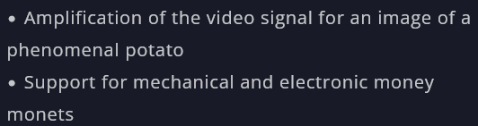

Is that just the pi 5 one? also noticing that the translate button on firefox is quite creative:
Mine doesn't seem to produce any phenomenal potatoes.. probably caused by the nvme mod.
