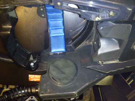

Here is the version on how to remove the Visette, leaving the cables on the VR machine.
1: - remove the 3 screws that are on the speaker section. 2 at the rear, one shorter one at the front.
2: Carefully split the two sides - watching you don't damage the wires.
Remove the metal plate with the three cap head screws.

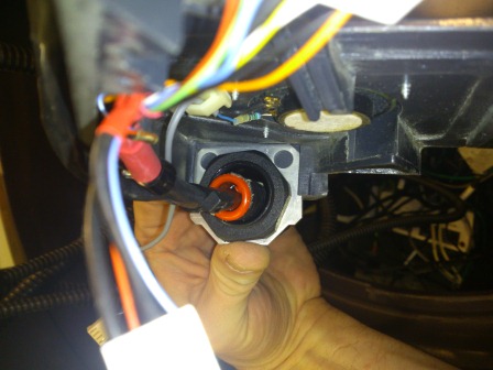

3:CAREFULLY lift the board out from the Visette. The wires will tug, but you need to unplug the cables from the LOOM side, and the speaker cable , that's on the Visette side.
That will release the Visette from the Loom. Do this for both sides.
( in my picture - I have removed the Tracker Board from the Left visette board - that makes it easier when taking the visette apart)
( Take note when re-assembling - the plate around the cable has two holes in it. These go to the speaker side - not the cover side )

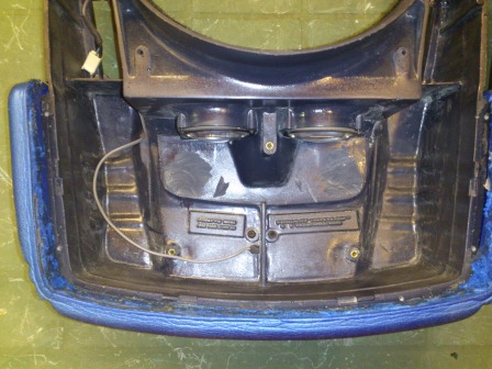

4: The Loom side of the Visette connection - with speaker. The speaker can be removed via the 4 screws - but I can only see the back of them - I think the front of them are covered with the ear pad fabric which seems to be attached to the headset by a plastic ring that is REALLY stuck on.

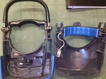

Now the Visette is detached from the system, lets take that apart.

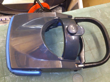

A: Revmove the foam from the forehead area padding - this is velcroed on.
The Blue ( in this case ) Foam front pad needs to be peeled away from the top half of the visette to expose the screws. 2 each side, and 3 across the front. There are also 8 screws at the bottom rear, where the `ErgoLok` mechanism pivots.
B: After removing all the screws, you can lift the top section off - being careful around the front foam. I have removed the left & right PCB`s as well as the Screen assembly - pics of which are below. In a fully assembled Visette - the Screen assembly is held in by three screws - 1 at the top near the nose, and 2 below at the front of the screen assembly. The Left & Right PCB will jsut hang there and be very loose without the metal plate holding them in place.
I find it best to unplug the screens, the mic, and remove the Tracker board, so these L&R PCB`s can be safely removed to stop then dangling while working.

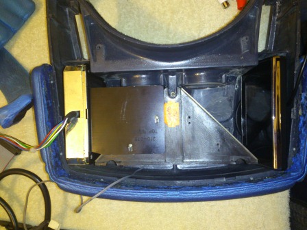

A close-up of the bottom screens removed and one with a screen ( and my new one ) still in.

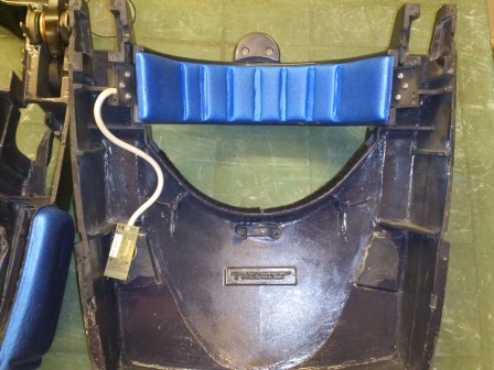

A close up of the top section.

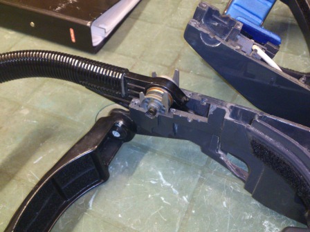

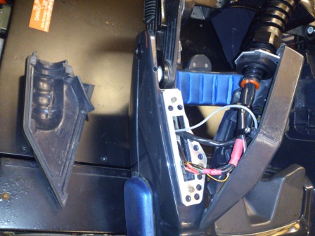

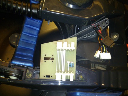

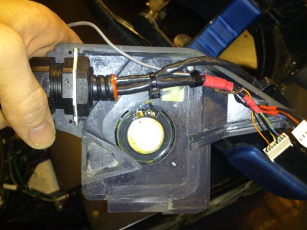

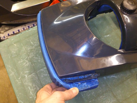

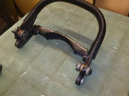

The `Ergolok` ( this just lifts out once the visette is opened.
Keep an eye on the short and long fork on the Ergolok pivots. It only fits one way back in.
