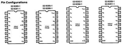

Dose anybody know what programmer can burn this kind of non standard pinout proms?
Here is the pinout: https://archive.org/details/6309PROM/page/n3/mode/2up
I did try to make an adapter for it like the 6353 but the E2 is active high on the 6351. I did try to negate it with an LS04 (powerd externaly with common ground) but my labtool-48 still dosen't like it.
Thanks.
