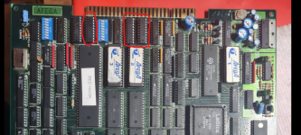

So i probed around for a while , Marking chips and only found a 245 that had a few outputs dead , So i piggy backed and still no output. This could have been correct but the only way I would know was to pull it. First bit of a test on the board to see how easy it was going to be , Its was not easy. Could not do it and was worried about wrecking board so cut the chip. Pics here of the chip and the board.
Socket and replaced and no different !!
So started probing again and a 245 near the CPU seemed to have something to do with it. I piggy back and got graphics back !!
So i pulled the 245 , socketed and was all good !
So onto the controls issue. Now when coined up it starts to rotate player. So basically its selecting player 2 (Start) and pressing right button rotating. Tracked this down to yet another 245 in the controls section (Will mark below). Pulled and socketed. So player 2 ok now but none of player one where working. Yet another 245 same area ! socketed and replaced. Now cant start player 1 or 2 game. Yet another 245 faulty !! Pulled and replaced and controls are restored.
Below in red are the 3 replaced to fix controls :-
