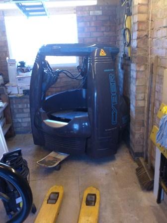

And this is my VR CS1000
simon_m74
Virtually real!
357CR

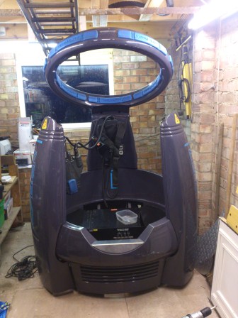

This is my machine just after it arrived at the start of the year.

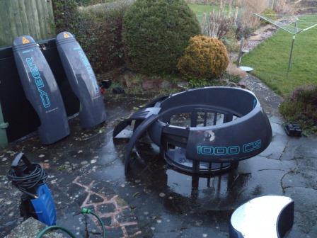

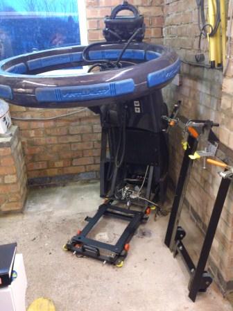

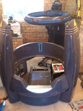

I stripped it, to clean off all the dust it have collected over the years in storage.
During the cleaning process, it developed a problem with the LCD screens in the Visette.

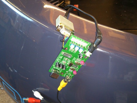

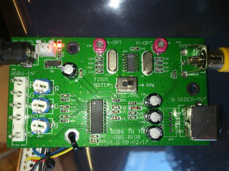

I have finally found the problem, and sourced replacment LCD`s ( with a higher resolution ! ), that require a composite video input.
I have added a power socket, so I can supply power to the new LCD`s and the CGA->Composite converter boards ( one is shown - the other is on its way ).

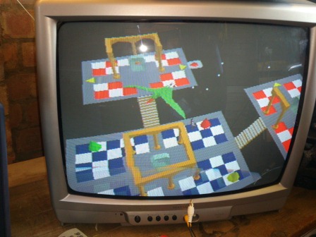

I hooked up an old CRT TV to the composite output from the converter board, and got a brilliant picture, although reversed, due to the use of mirrors in the visette.
Below are pictures of the strip down, the clean, the rebuild, and the repair work.
More pics to come in the technical soon, when I get back to repairing/rebuiding it.
Simon
