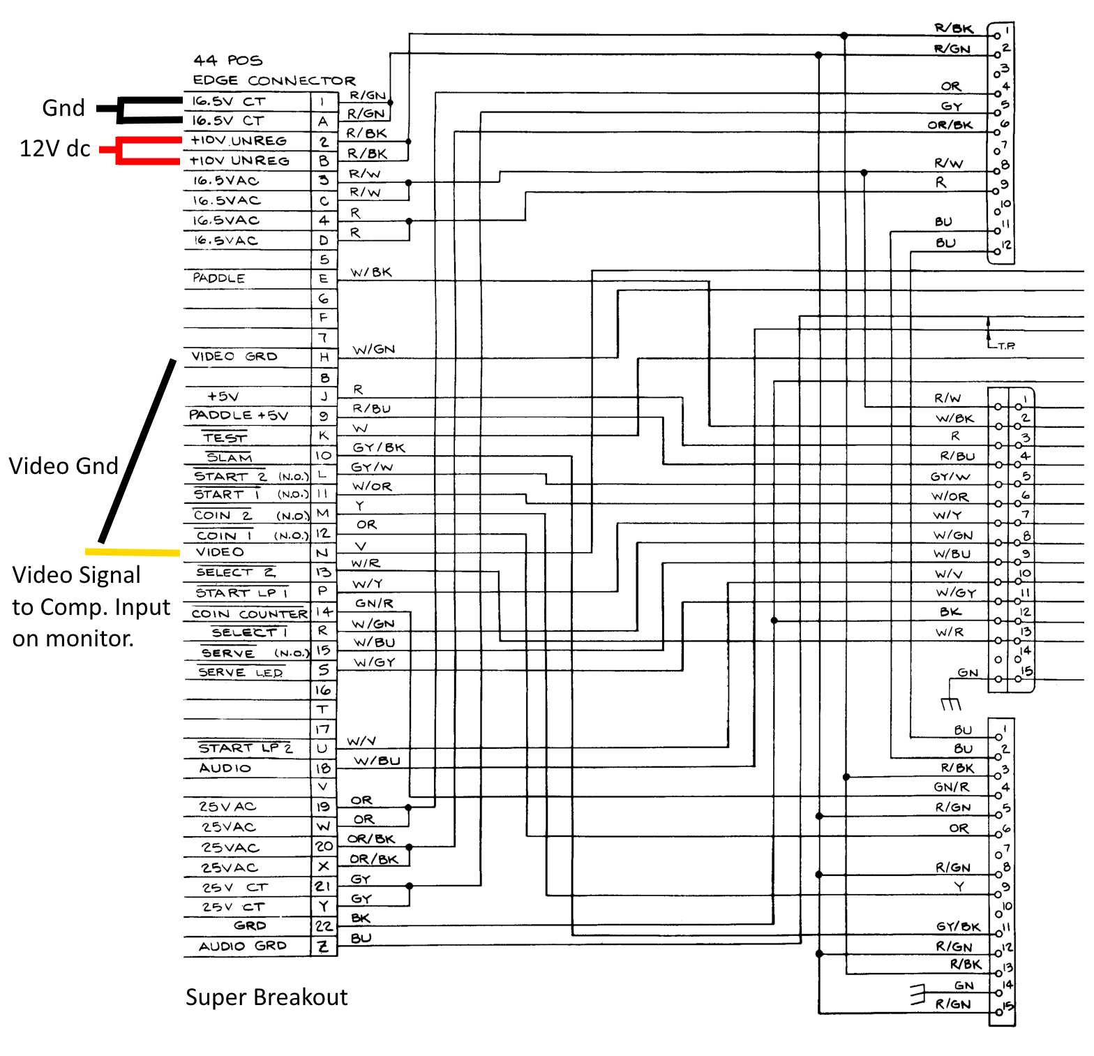

My test rig is crude, but for getting the Game logic on the board works fine. The way I read the schematics led me to believe what I'm doing was OK. The LM323 regulators are tolerant to this input voltage and I've had perfect 5.0x DC reading all over the IC's. This is tested to work on Super Breakout, Fire Truck and Super Bug boards, all you need to do is move the video signal/gnd and any input pins around on your adapter for coin/start. etc.
Your 12Vdc will need to be beefy, my Jamma Rigs 12Vdc was not man enough to supply enough current to make the board run, I went for an open frame PSU I had spare that was rated at 4amps and worked fine.
The other AC voltages I left off they are for the Audio amplification, I left them alone and tested sound when the game was back in the cab.
See image below of my wiring.

Wow, cheers, that's super helpful, I actually don't know if the board is faulty or not to be honest, I couldn't figure out how to supply it the voltages it wanted at first.
I didn't think of driving 12vDC into the 16v inputs, what I was looking for was creating test points on the other side of the DC conversion to plug +5 etc into via jumpers.
I can feed it a 12v @ 4A supply no problems, I have a few different PSU's that are up to the task.
