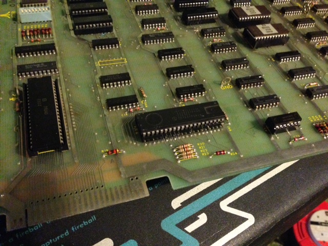

a) The 4 paddle positions on Warlords are read using analogue to digital converters (ADCs) inside the sound chip (C012294-01 a.k.a Pokey). So I tried swapping this socketed chip for some others I have. This didn't appear to improve the problem. Also I have no easy way to test the ADC logic in the Pokey chips independently. Either all my Pokey chips had bad ADCs or the problem was elsewhere.
b) The only other semi-conductor that might break just some paddles is the LM339 @ A5. So I socketed this and replaced it, but it wasn't the problem.
Pokey is in the lower-middle of this picture and the quad op-amp LM339 is in the lower-right.

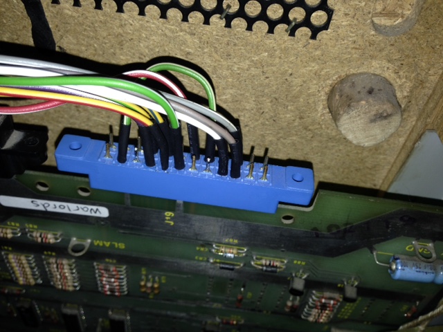

c) I noticed that the drift reduced when I held the smaller edge connectors (P19). I'd already cleaned all the edge connectors, but P19 wasn't making robust connections. The video comes off P19 as well and that was also playing up if I touched the connector. So I replaced the old original with a new connector in the loom and that significantly improved the problem on some paddles but not all. It's so awkward re-wiring looms inside the cab.
