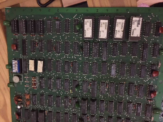

Repair: replace EPROMS at 9E, 9F, 9J, 9K, 9N, 1C and SRAM at 1S

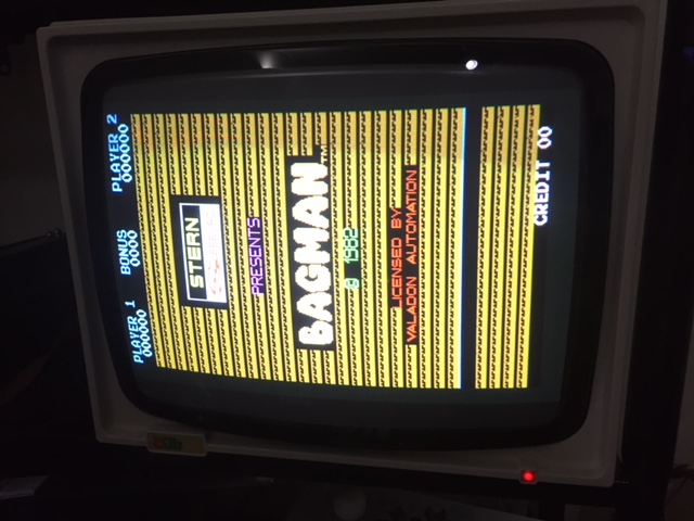

First plug in, voltages ok. Garbage on screen, poked the reset pin of the Z80 with the scope and it was in a watchdog reset cycle.
Checked the first EPROM at 9E and it was duff, replaced, now signs of life...

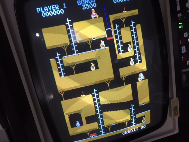

Check the graphics ROMs, the first one at 1C was bad, looking much better... but there's still a small graphics glitch, in this picture you can see a few red lines a way down the screen under the mine cart, a similar red shadow under the lift on the second screen and there were a few other small glitches.
Kinda felt a bit ram related, luckily they're all in sockets on the Stern boards. Most likely the 82S16 SRAMs at 1P, 1 R, 1S, 1T.
I tried swapping them about to see if the problem moved, when I swapped 1S, 1T the glitch turned yellow so we're onto something. Swapped one of them out and all seems ok. Need to order some replacements though as I had to borrow one from another board.
