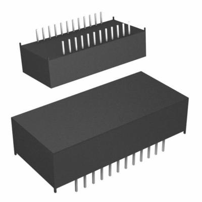

I’m adding a high score save
To my bomb Jack, ( trying to )
I have the M48z02 Upgraded back up Ram fitted .

I slowed my write speed down and it wrote and verified and is good,
But the ram I used is not ,
Updated high score Jrok rom file runs fine ,
Jrok recommends this ram . So I’m not sure what’s occurring ?
I will used the Dallas one now (
Should have just gone with it in the first place !)

I looked back over this
And you can get 2 ver. Of the
St type non volatile sram
M48z02
One is M48z02-12
The other is M48z02-70pci
I bought the later .
And all the data sheets of the
M48z02-70 I can find refer to the -12 being a direct compatiblity for the Dallas and do not even mention the -70pci type ?
Which is weird to me as this is the data sheet for the -70pci
And it waffles on about the-12
Anyways live and learn orderd the Dallas I knew I should have orderd the Dallas to begin with.
