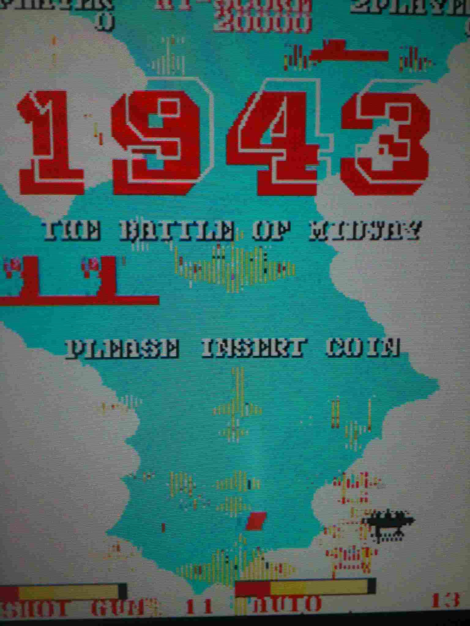

I recently bought a non working capcom 1943 off a member on here, so here is what happened, the sprites and the background had faults.
I first looked at the background troubles, then the clouds dropped down the screen there was red chunks coming down with the clouds! you can see it in the pic, on the left and near the top of the screen. Also the ship had a extra red and blue 'blob' on one side of its hull!
bit of prodding and poking and found ROM 10F was dud! a couple of the pins were bad so it was trying to work!

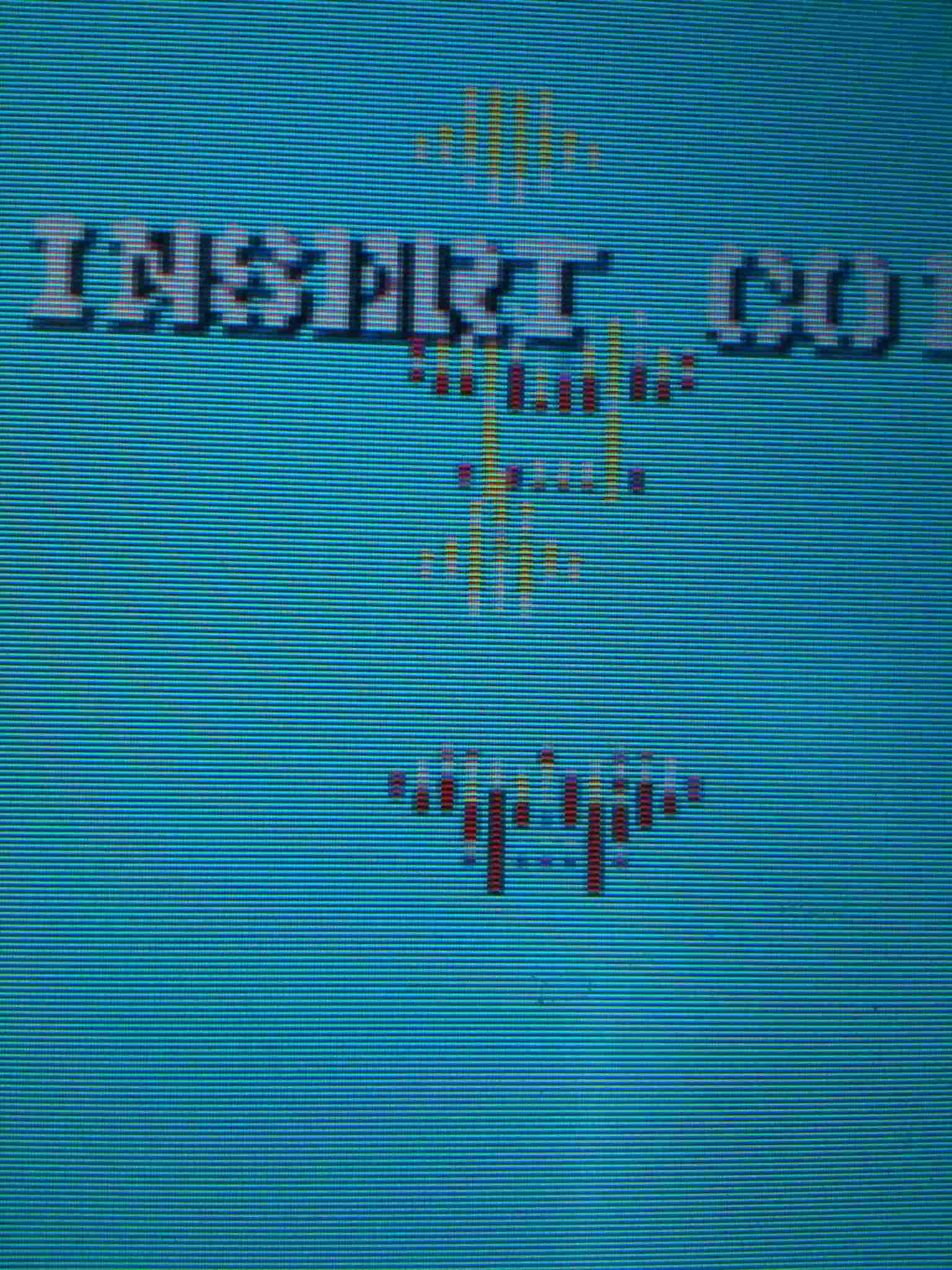

A study of the sprites in freeze mode revealed the sprites were actually there, just one was misplaced with respect to the other
Look carefully and you can see the other half of the planes above!
so there misplaced vertically to each other!

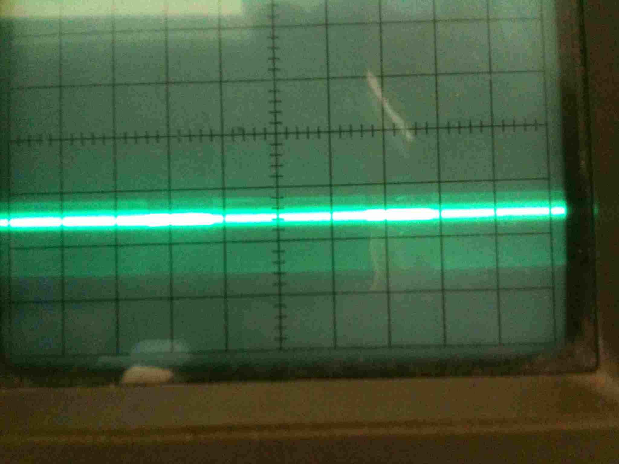

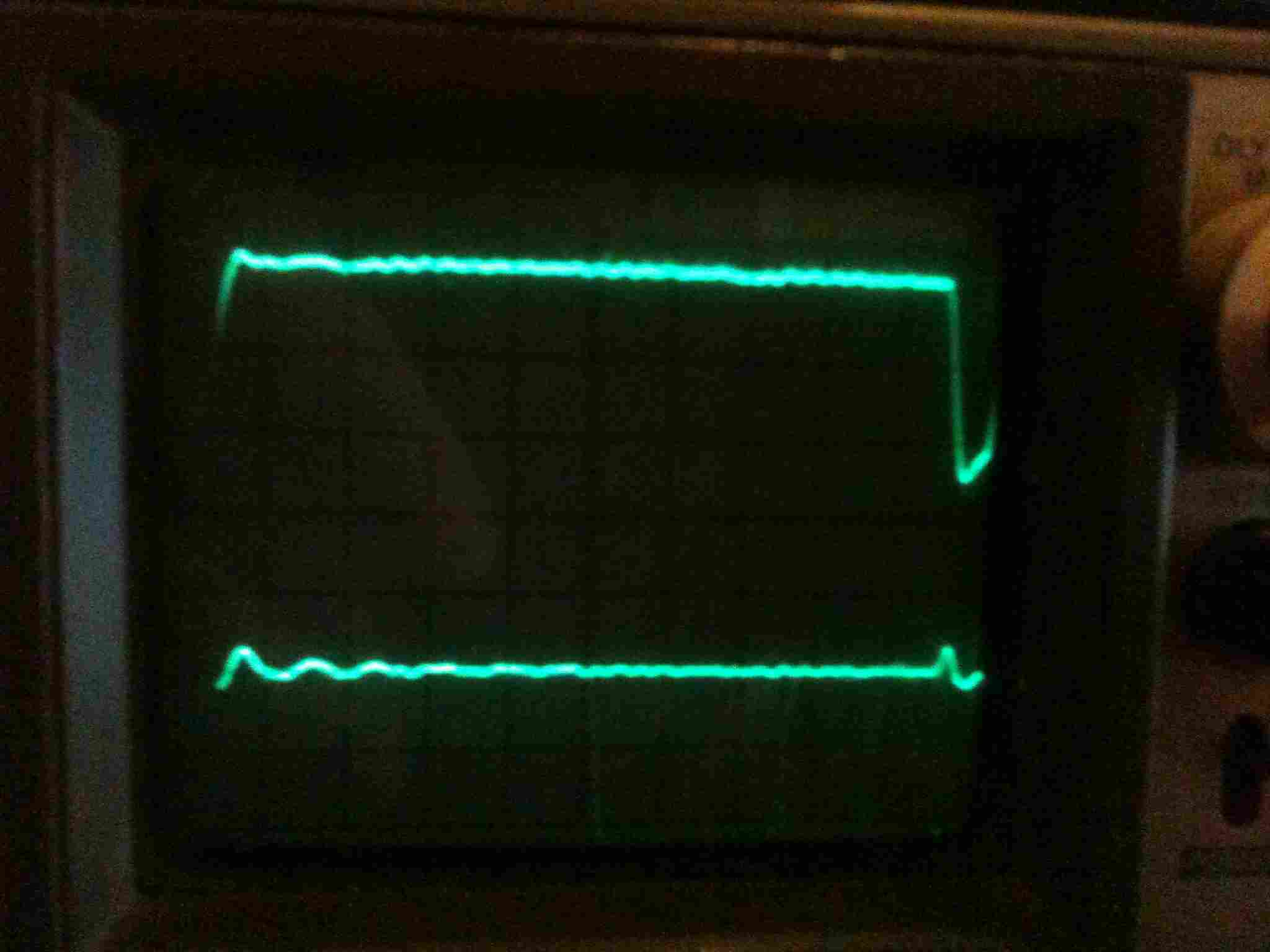

VERY VERY careful inspection (and then comparison with a bootleg board) found that signal DF5 being fed to pin 4 of the 74LS163 at 10E Was indeed very slightly sitting on the ground line compared to the other lines DF4, 6 and 7!
this is a good pin DF4

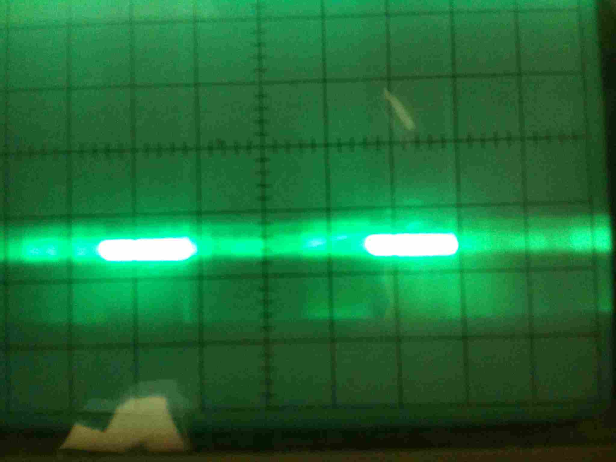

Between the bright bits is the data! difficult to see and take a pic off but it is there! on the faulty pin it was like this...
OK it looks more different in the picture than it did in real life!!
