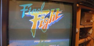

A nice if basic writeup of some faults and where to find them. Looking at the motherboard I saw the frame ram chips were Sony CXK5814, which from memory (oops bad pun) fail a lot, so piggybacked one with an equivalent TMM2018 and got this;
Progress, but no objects or backgrounds, just one layer of graphics, which I assumed was the 'character' layer.
Replacing all 4 frame buffer rams got me this;
But still no objects. Could see some faint discoloured pixels in the centre and bottom of the screen. At this point I suspected video ram or the dreaded CPS-A-01 failure, but as many will know the motherboard is underneath the romboard its a right pain to work on.
