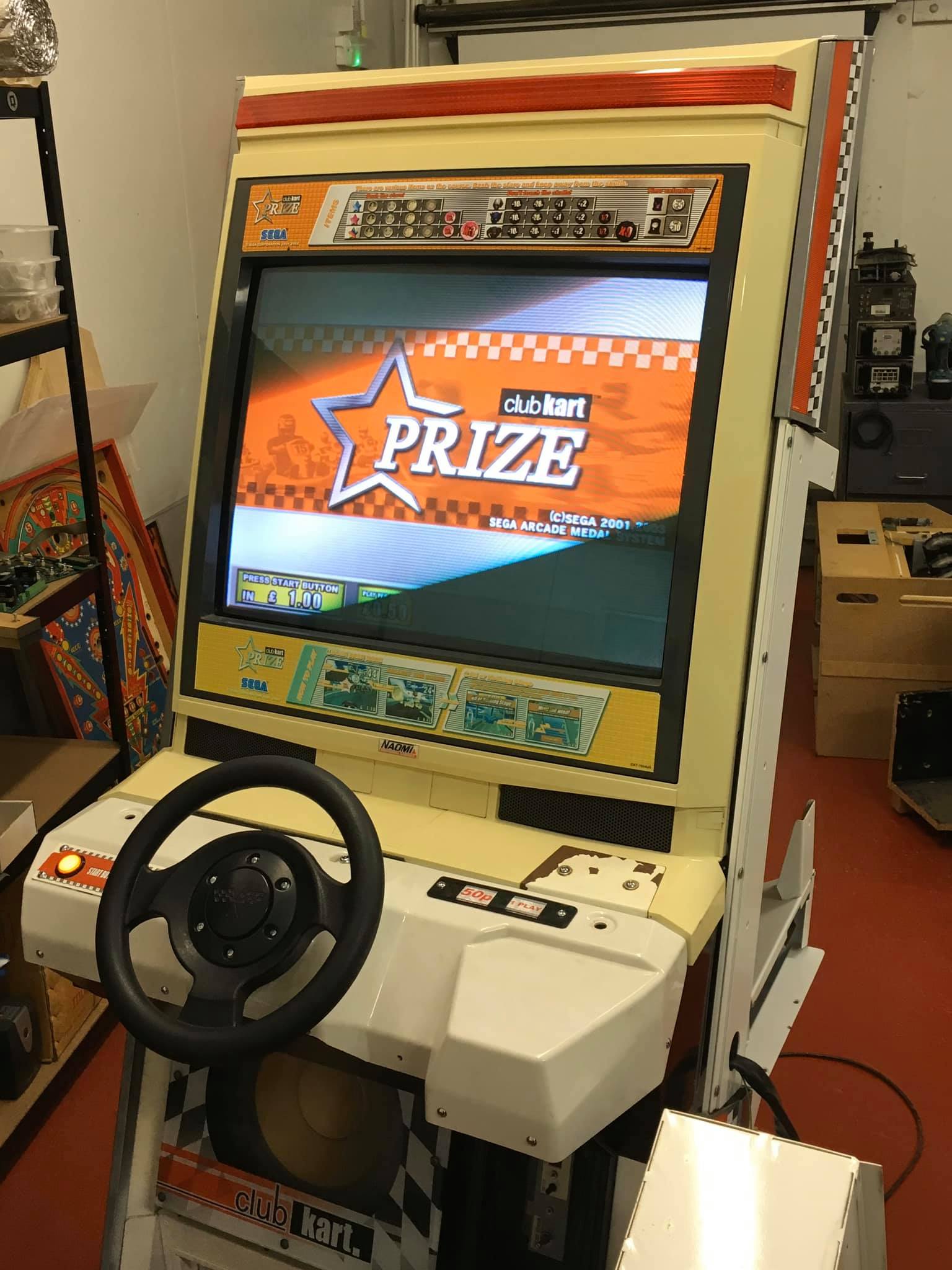

So here we have our candidate for conversion. The upper plastic actually came from the other cab that had the plastic really badly melted by cigarettes and the former owner had just painted over it with some black paint. The seat had also been painted with nice thick gloss paint. Lovely brushstrokes visible all over. So lots of stripping, sanding and filling was required!

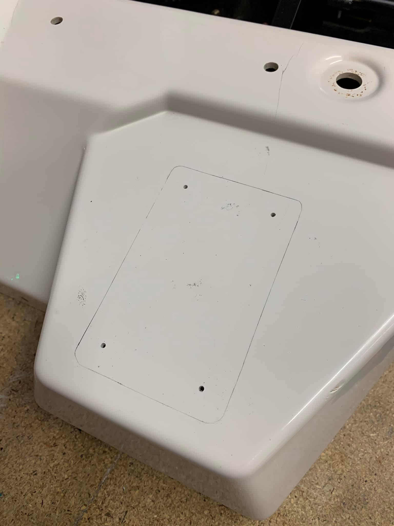

The next job was to give the shifterless driving CP, a shifter! Had one to spare from a dead old touring cars dash, only thing was to figure out how to fit it. What i did was, seeing as the metal mount plate for the shifter actually exists beneath the plastic, i flipped the thing upside down, and poked with a little pokey thing with paint on, through the bolt holes onto the underside of the plastic. Then drilled those through.
Then I made a paper template of the shifter plate, traced round it, and dremelled the plastic so that the shifter mechanism would fit through. I got a little eager with the old dremel and there was the slightest of gaps but i managed to cajole it into place so you can't see it on the final assemby.

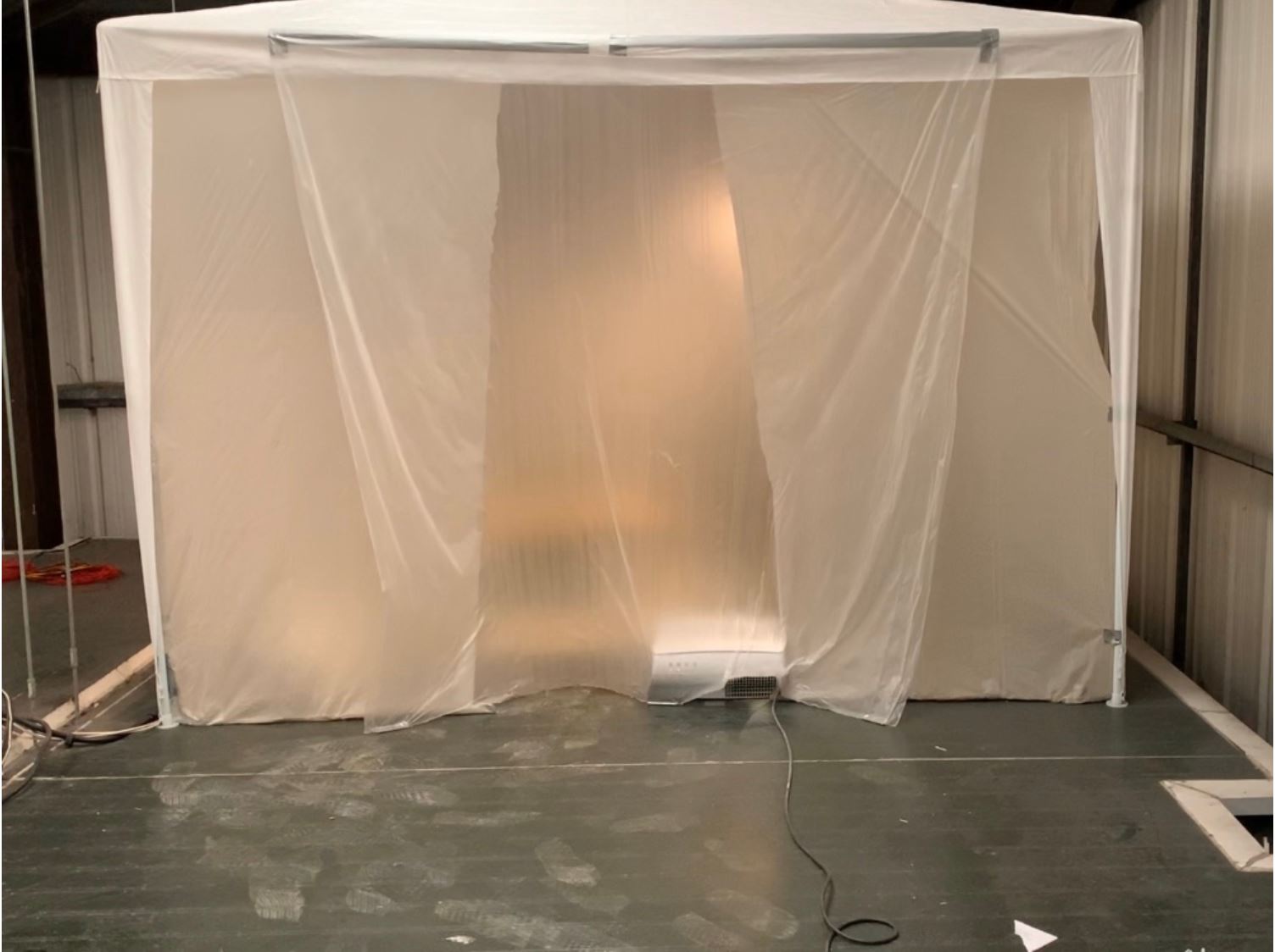

So.. I gotta spray all this stuff. But I can't do it outside, and I don't want paint particles floating around and settling all over the unit. So off to B&Q i went, bought a £30 Gazebo and £5 of dust sheet. Plopped an air filter machine I had on the floor to do some particle sucking and it worked well! Lighting was a problem in there though so in the end i hung a work lamp on a stepladder!
