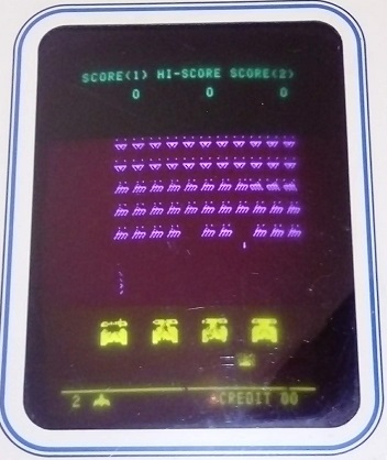

When I got my Cosmic Monsters table it was clear it had some sort of graphics fault.
The bottom half of the "invaders" are fine, but the top half was "random"
I was convinced it wasn't a ROM or RAM fault - the game plays 100% ok and the "invaders" look fine on the intro screen that shows the scores.
