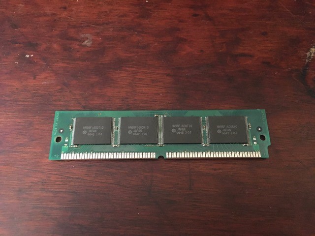

Looking at one of the SIMMs, the reason why was clear (top one in photo). A chip had actually fallen off.
So a 32MB SIMM was obtained (bottom SIMM) and the chip nicked off it (note they're in 'handed' pairs, so you need the correct side, I presume).

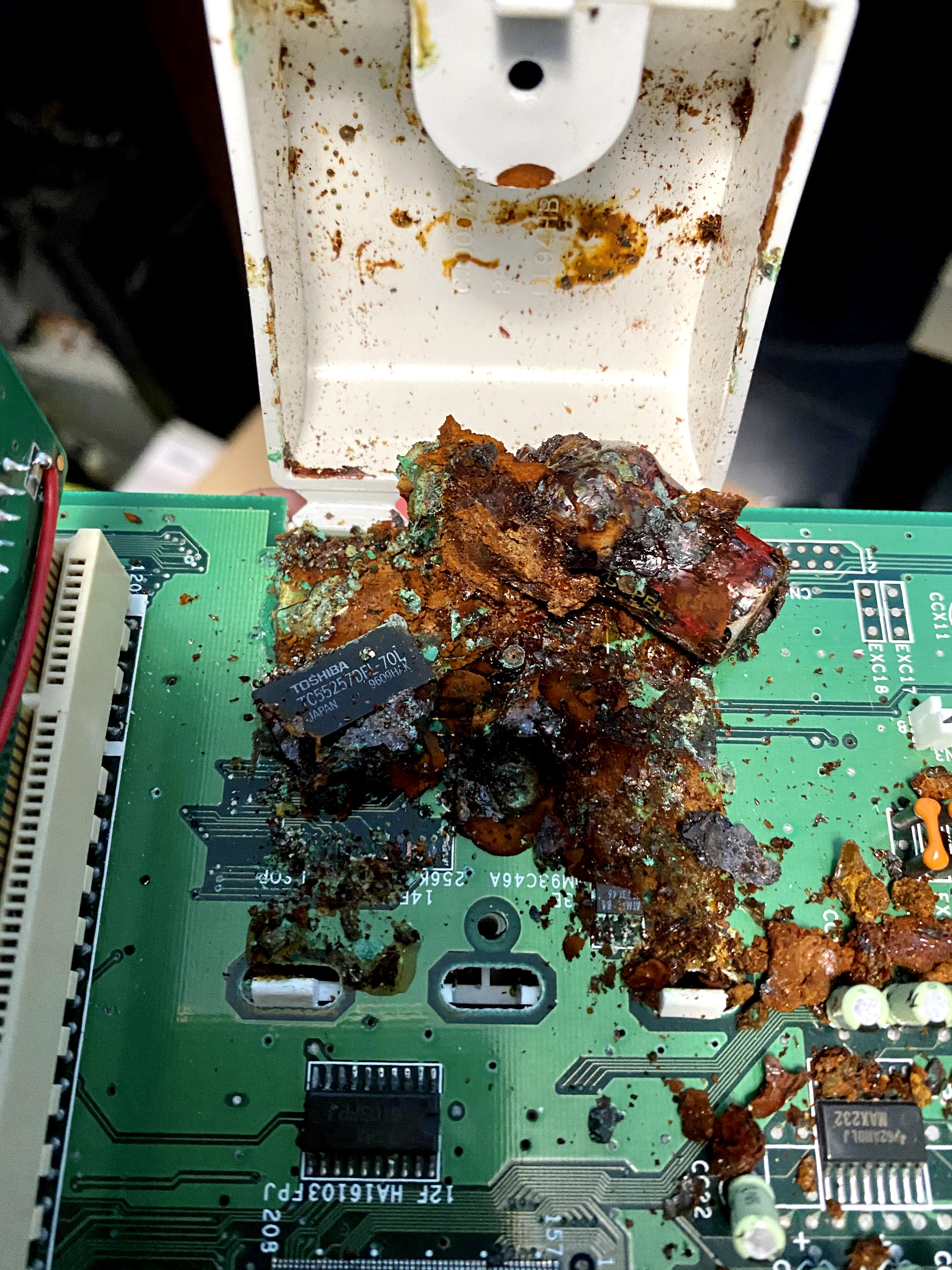

Great repair! Make sure to open the white plastic capsule and replace the lithium battery in there if your board has one. This is the surprise I encountered on my CPS3 board when I opened the capsule:
