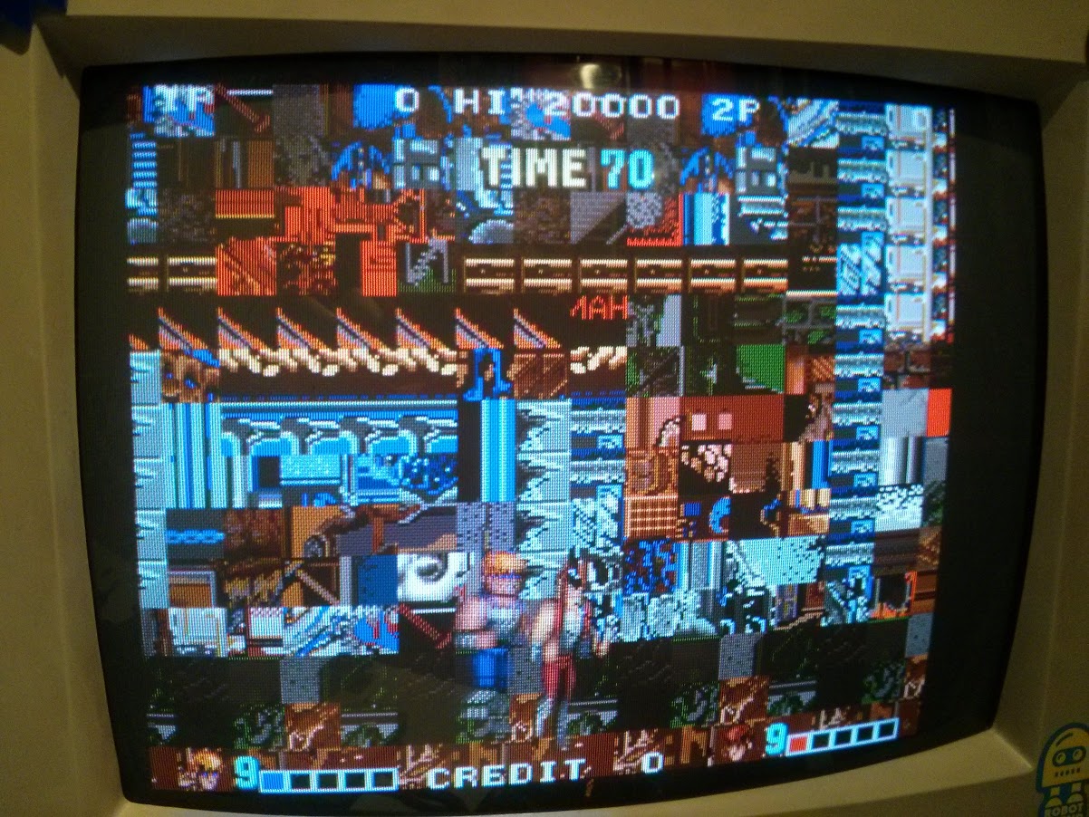

Got a Double Dragon with garbled background graphics;
I consulted the mame source to get the locations of the background tile eproms which tested ok. Schematics showed background RAM was at IC57, so after testing most of the surrounding logic with a probe I piggybacked a TMM2018 on it and got this;
Better, so I replaced the RAM, and bingo;
