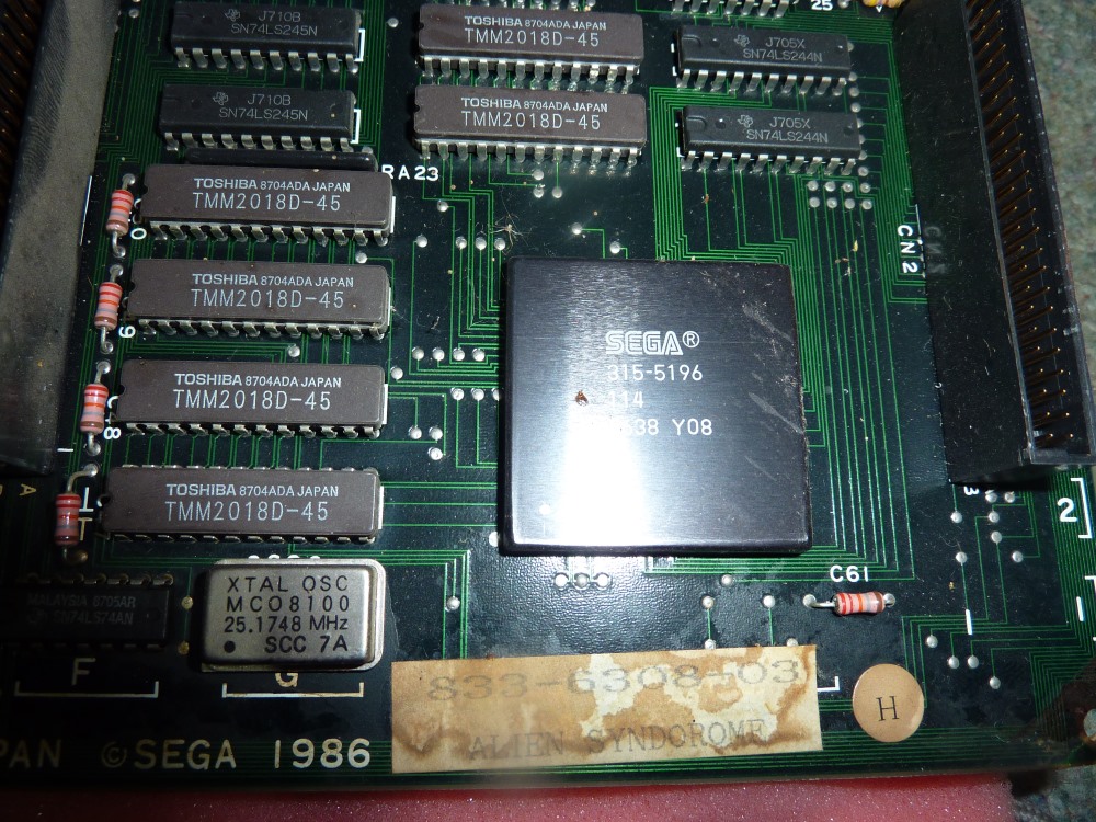

The upper ROM board was an E-Swat, the lower PCB originally an Alien Syndrome. Which explains why the upper board was in great condition and the lower board a little bit more grubby.

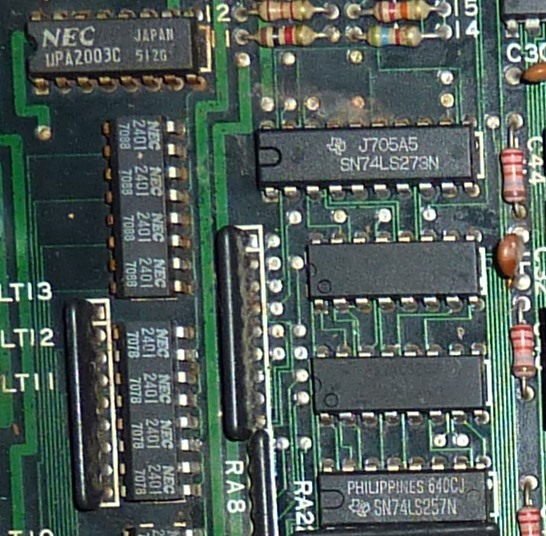

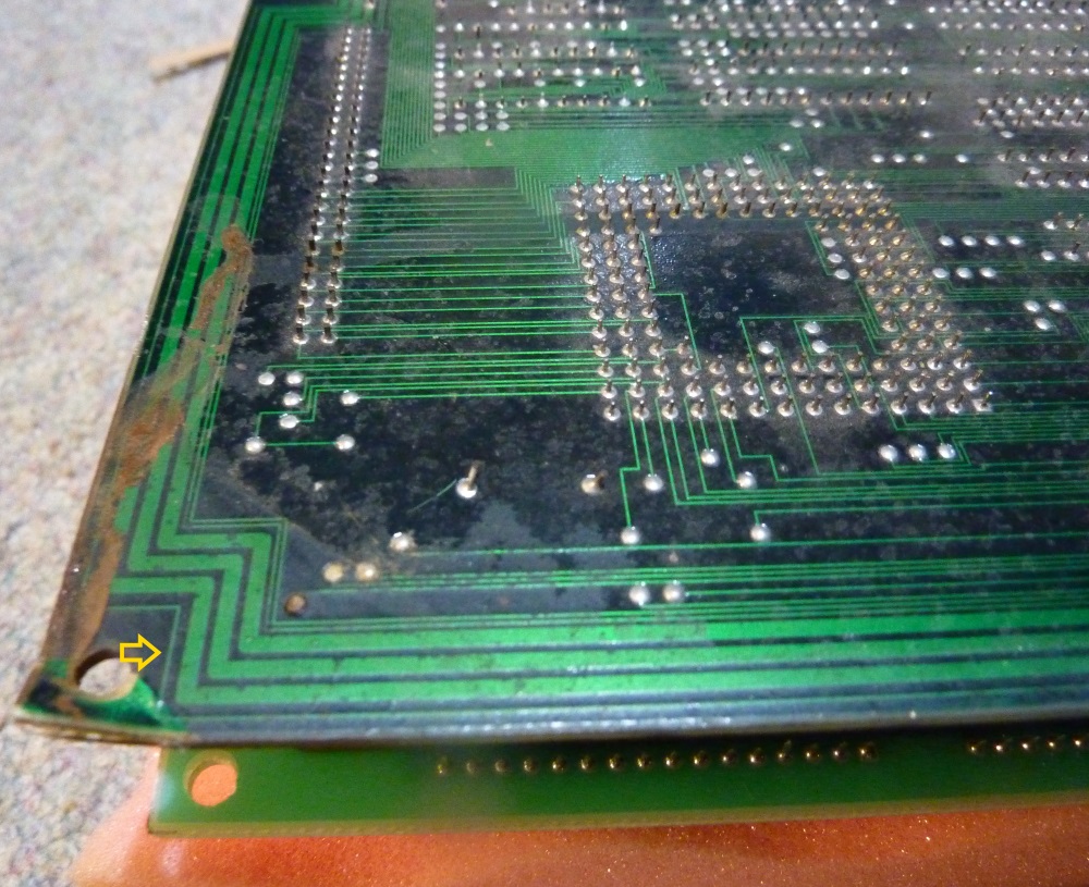

I inspected the board and noticed a corner had been bent. The track highlighted below was for the video sync. There wasn't continuity along this track, so that explained why the video signal wasn't syncing.

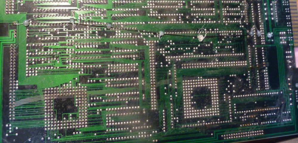

I patched the track with some kevlar wire. I secured it with the glue gun. Not graceful but good enough.

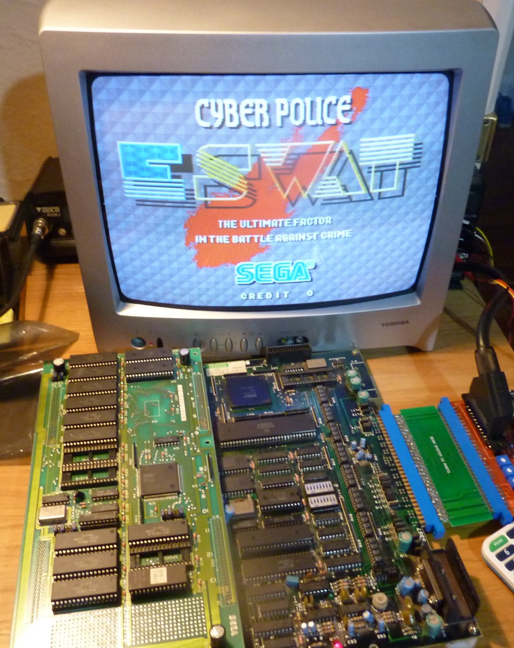

The board still didn't work. As a quick test, I installed the ROM board onto the Shinobi board I'd previously repaired. It worked fine and past all tests.
This was good news; it meant the ROM board was fine and I could concentrate on the main PCB.

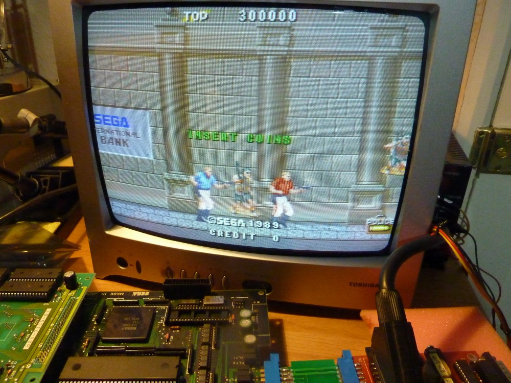

The board pretty much fully works and all tests pass. There are a couple of minor problems:
