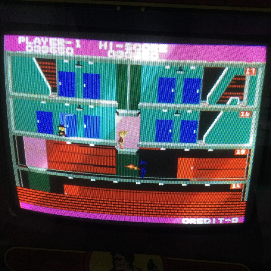

Extra “D” character above the word “CREDIT”
This is a bit of a weird one. All I know is that this
problem is definitely on the bottom (CPU) board.

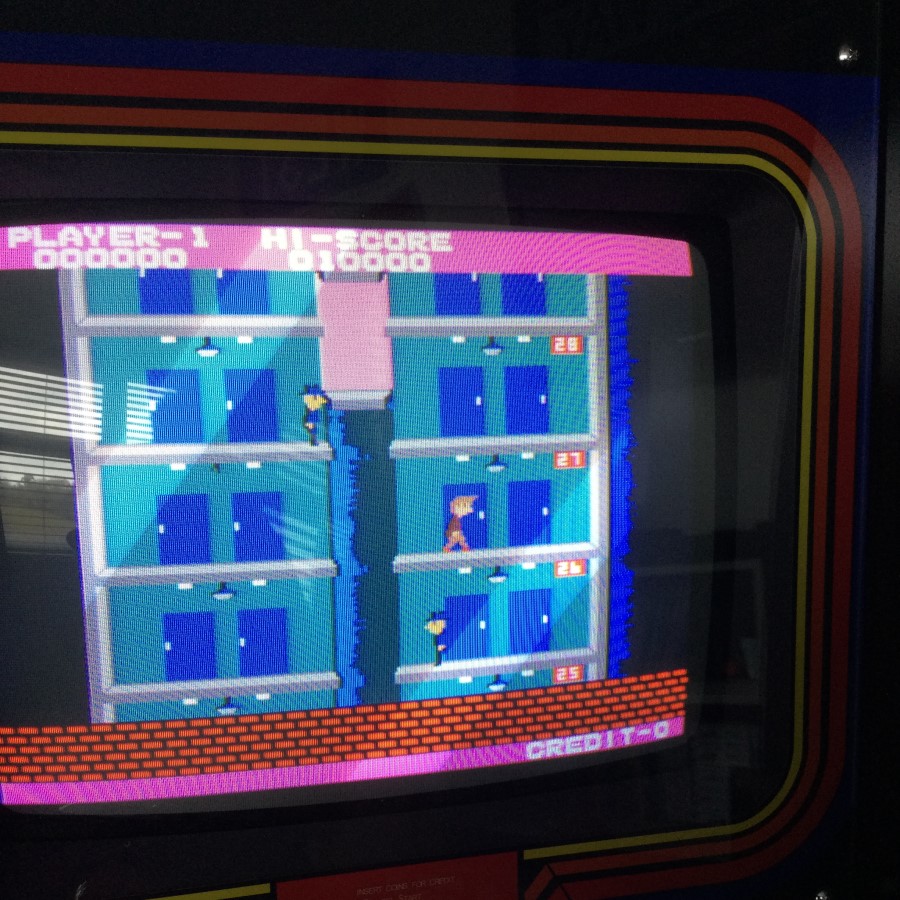

Red line graphic glitch
After the pcb set has been powered on for a quite a few
minutes, the following red lines start appearing onscreen…
The red line issue only seems to happen on a black
background.

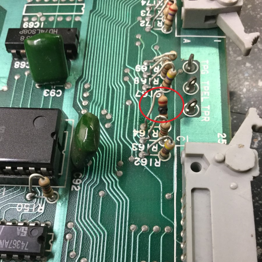

Knowing this issue is definitely on the top (Game Board)
pcb, I thought I would take a closer inspection of the board. I noticed a 270
ohm resistor at R164 is badly burnt…
The 470 ohm resistor at R162 also has some minor burn, so
I replace them both. It made no difference.

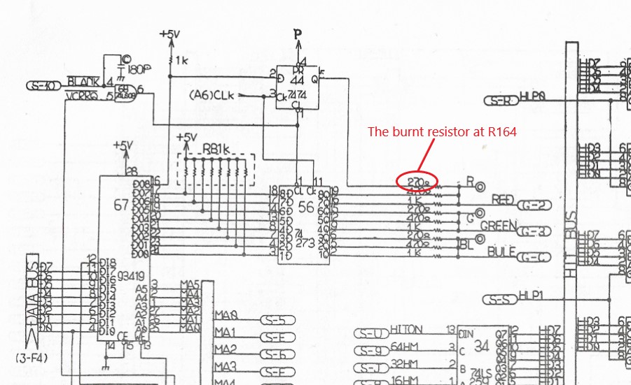

I’m curious to see what part of the circuit this resistor
is connected to. I get out the schematics and have a look around. I find
something interesting, the burnt resistor is part of the red colour circuit and
is the only resistor connected to a 7474 flip-flop at IC44.
This red line problem only happens after the board has
warmed up and I wonder if this IC is the likely culprit which caused the
resistor to burn out in the first place?

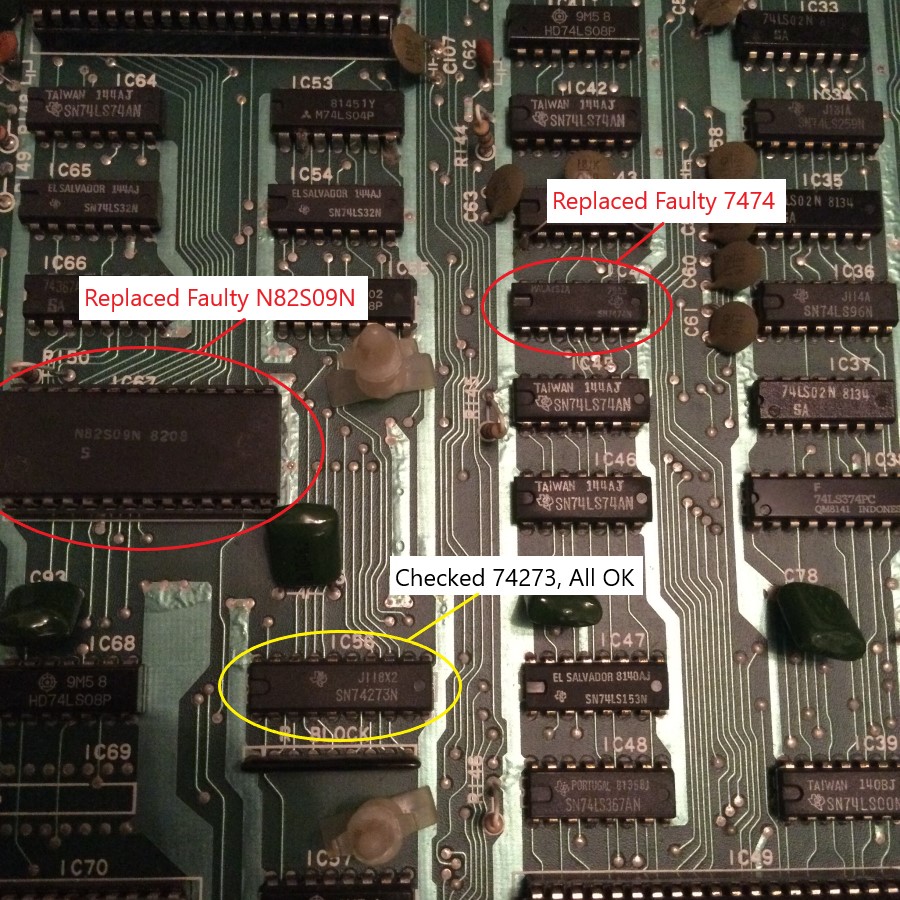

I removed the 7474 and put it in my tester…
It fails! I solder a brand new 7474 chip into IC44 and power up the board,
it fixes the red line problem
. At this point I’m thinking the board is now
fully repaired and everything seems to be running nicely
Then about 30 minutes
into soak testing the board set I get this…
I have now got blue colour issues
. I take a look at the schematics
again, I’m now thinking maybe the 47273 flip-flop at IC67 has gone bad
too. I pull the 74237 and check it in my tester, it passes fine so it looks
like that’s not the issue. The only other thing I’m thinking is that maybe the
N82S09N bi-polar ram has now decided to go bad on me. This time I rob a N82S09N
chip from a non-working Wild Western stack, it fixes the blue issue! Just to
make sure it’s not some sort of connection/socket issue, I put the old N82S09N chip
in again and the blue comes back, put in the Wild Western N82S09N donor chip
and the problem disappears.
These are the chips in the colour circuit that I replaced
and checked…
background.
and checked…
