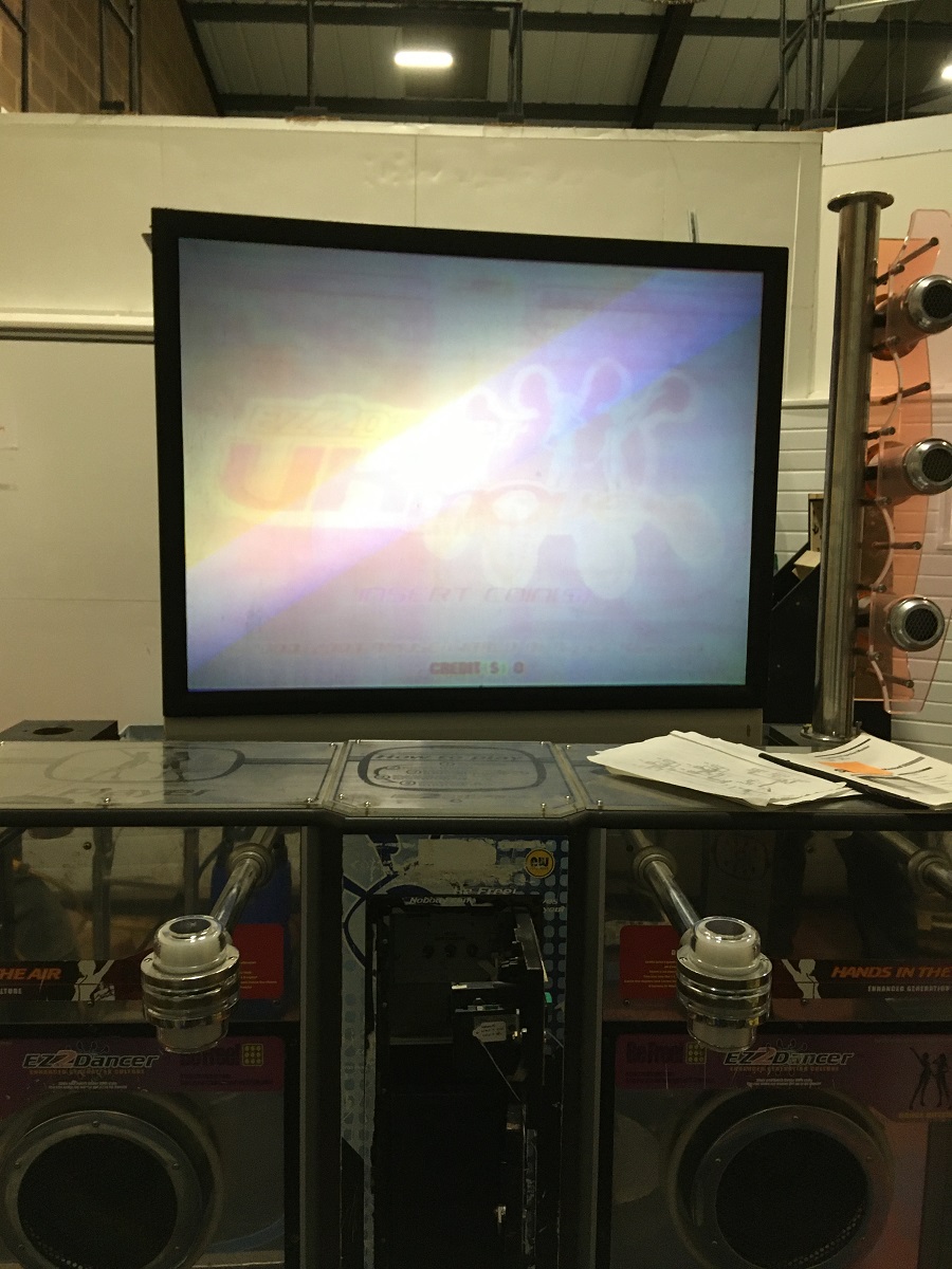

The projection screen could do with a re-tubing, something with a little less burn which on a white screen looks like this:
It's perfectly playable at the moment though, purely cosmetic burn. The projection monitor power supply has one large bulging capacitor though, so I'll be working my way through that as well next. I'de also like to replace the projection screen due to various scratches and damage. Thanks kids, for taking the sharp end of a toy and scratching it back and forth across the screen! Little b-stards!
