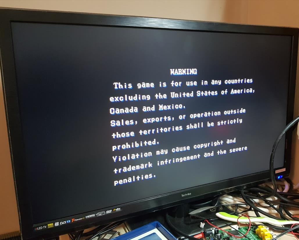

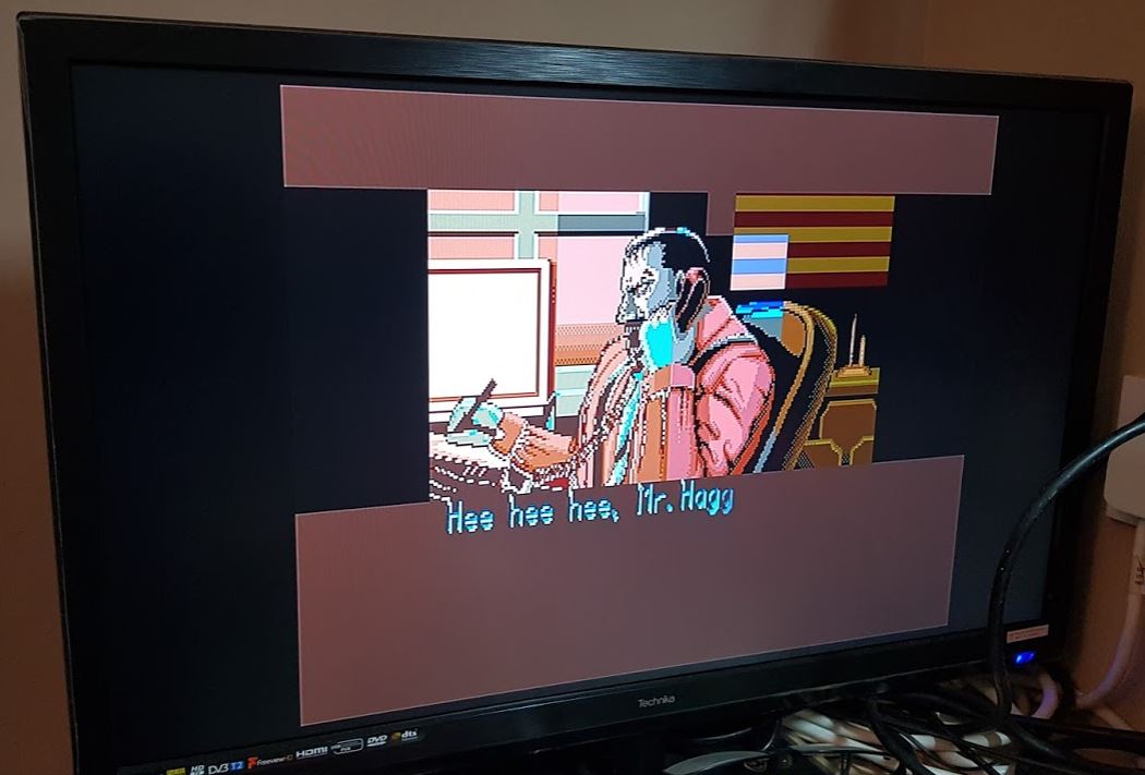

I fired this up with a good A board and the board fired up ok and sound and initial graphics looked ok but when the main screen showing the final fight kicked in it showed graphics issues :-
So i suspected either the main Background rom or the C board - The easiest way to test is with a known working one and luckily i had one. I fired it up with the working C board and everything was good. This sadly confirmed we had an issue with the C board.

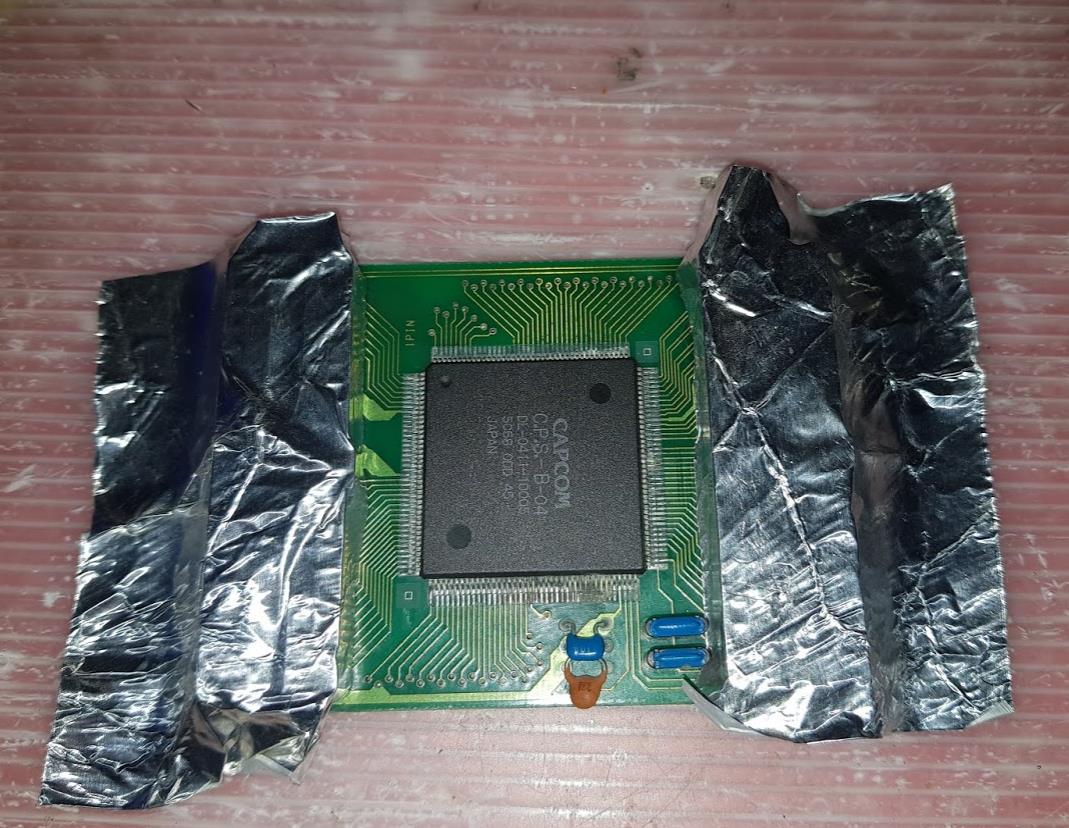

Whipped the C board out and had a look under scope - did not look good :-

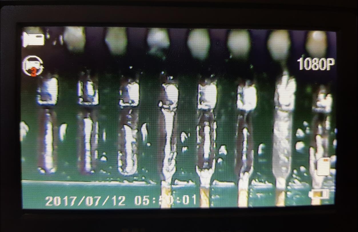

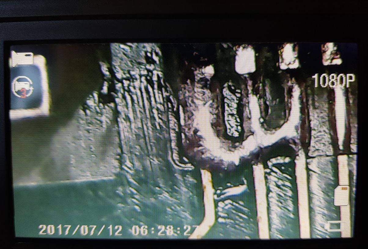

Image here just to show that having a microscope is very handy as I had not noticed i had caused this :-
