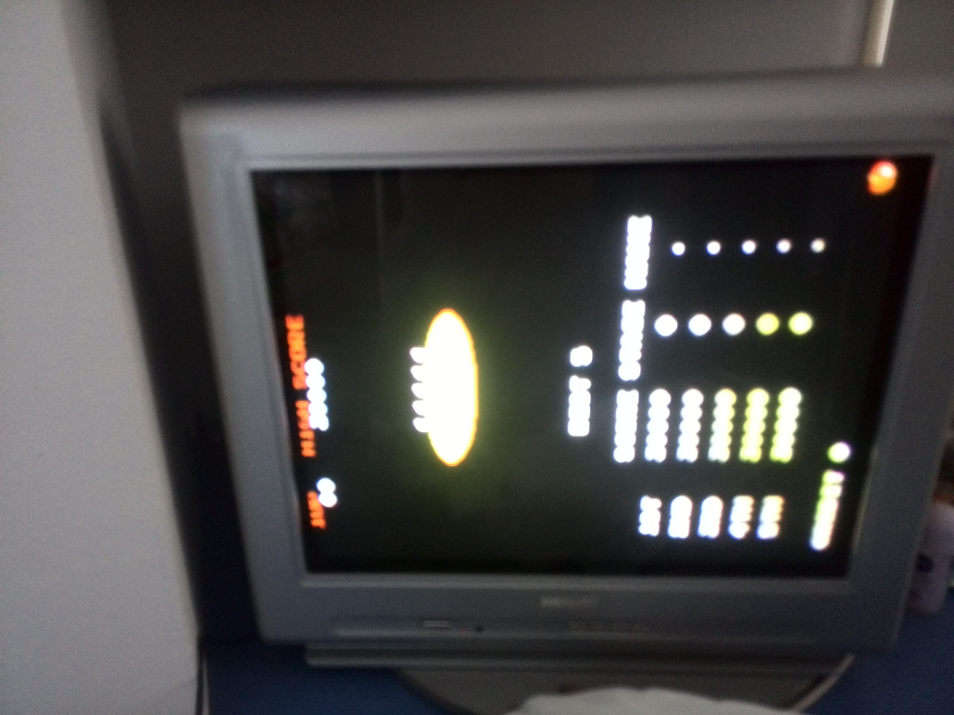

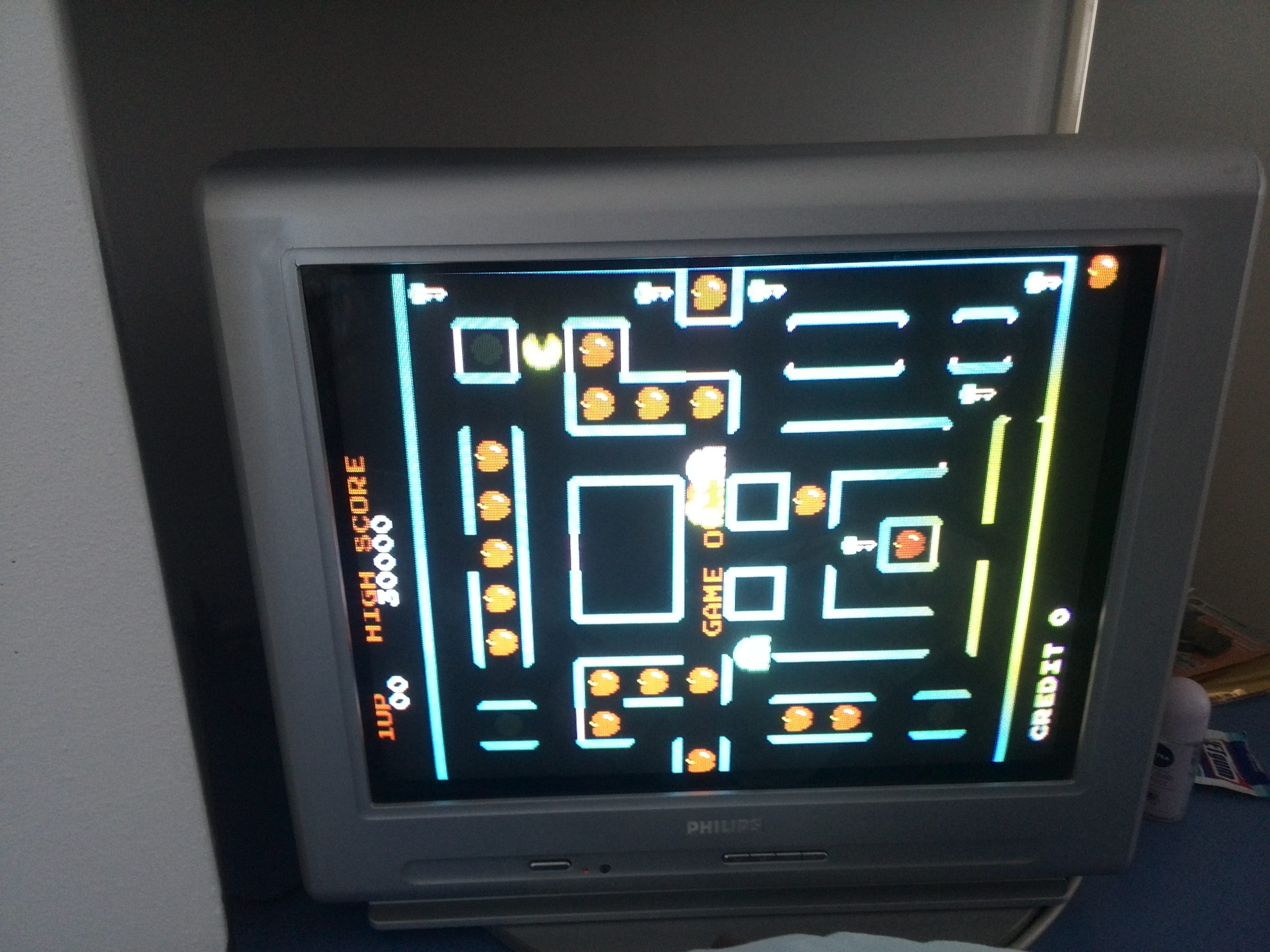

Then fired up the board. And there I go 44 pins left to see what was sync, found it. Found a color and then within minutes. Well photo's to see the result:
This was my first fix log, so maybe a little ruff. But hopefully you enjoyed it
