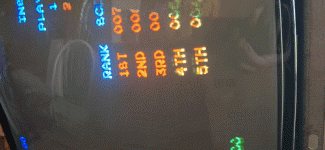

Got a new crt issue on Hantarex MTC900e

Ive read that the standard non e version is 126v but the e version (mine) should be 115v. what do you reckon??
The MTC900/E USA version is 115v. All standard MTC900/E UK/Europe versions are 126v. The MTC900 was the previous chassis to the /E, it looks similar but is a bit different in design, thought it used the same voltages for B+, so 126v for the UK/Europe version. You can tell the USA version as it doesn't use the green connectors for power and rgb, it uses the white/clear mate-n-lok/molex type ones like you see on a WG chassis. Also, the USA version doesn't use two separate voltages, it uses one voltage for both deflection and degauss.
