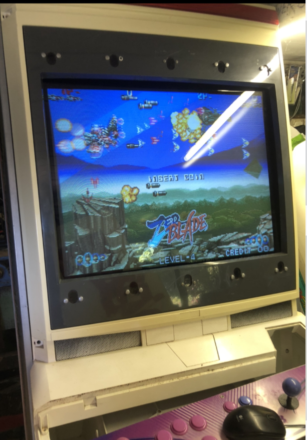

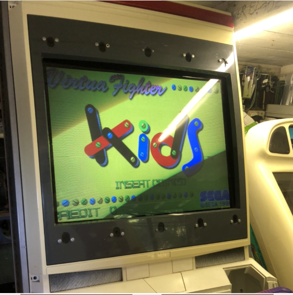

Got a wells 2792 in a Naomi today
6,490CR
Got this wells Gardner true flat auto tri sync
Into a Naomi today,
Thought I would share some pics
Been slowly putting this together from scraps..
D9200 auto tri sync . Vga,ega & cga..
Looking to add Mame gun games
And Naomi pitools multi gun games Retroman8392022-07-27 17:08:29

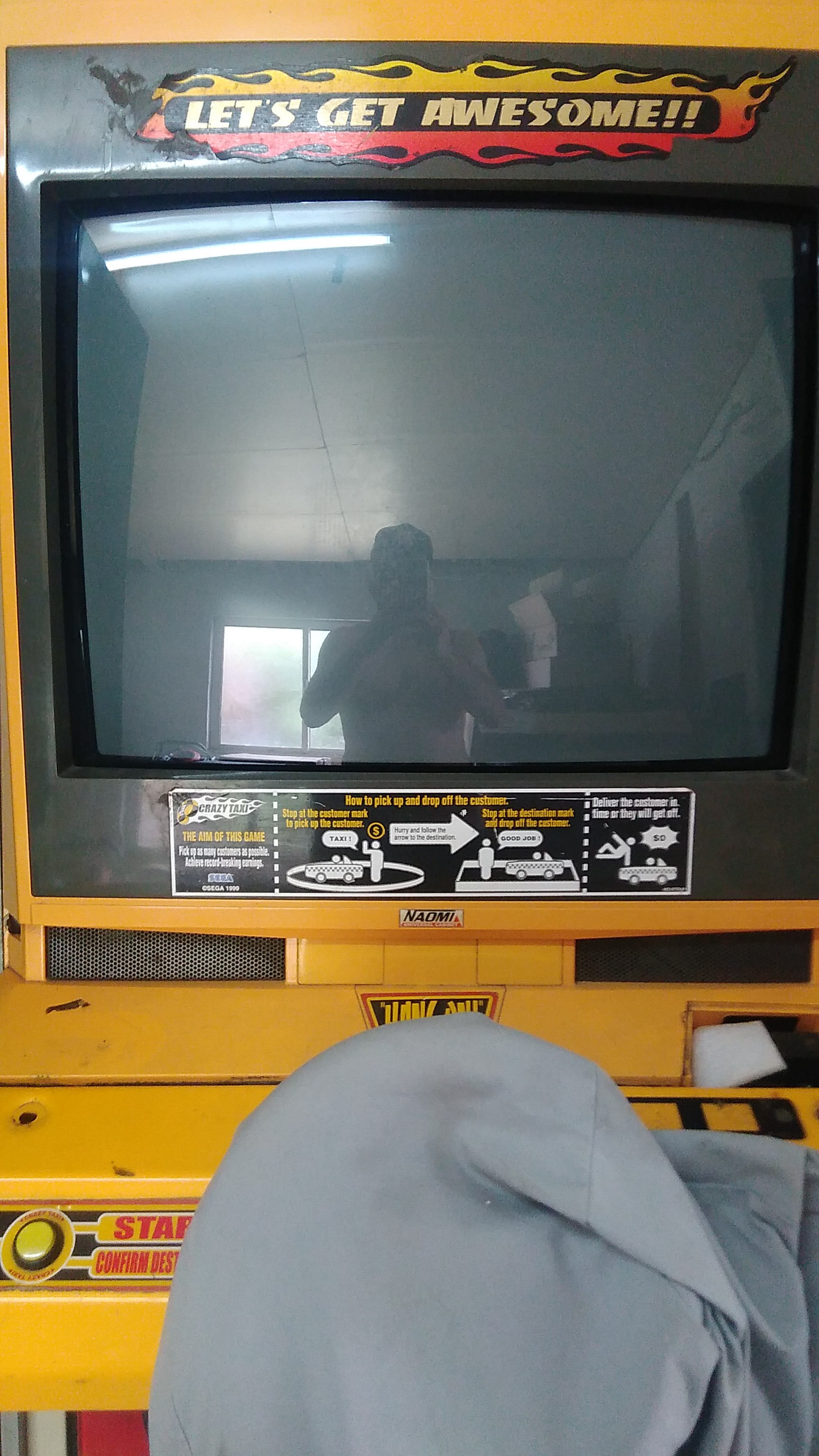

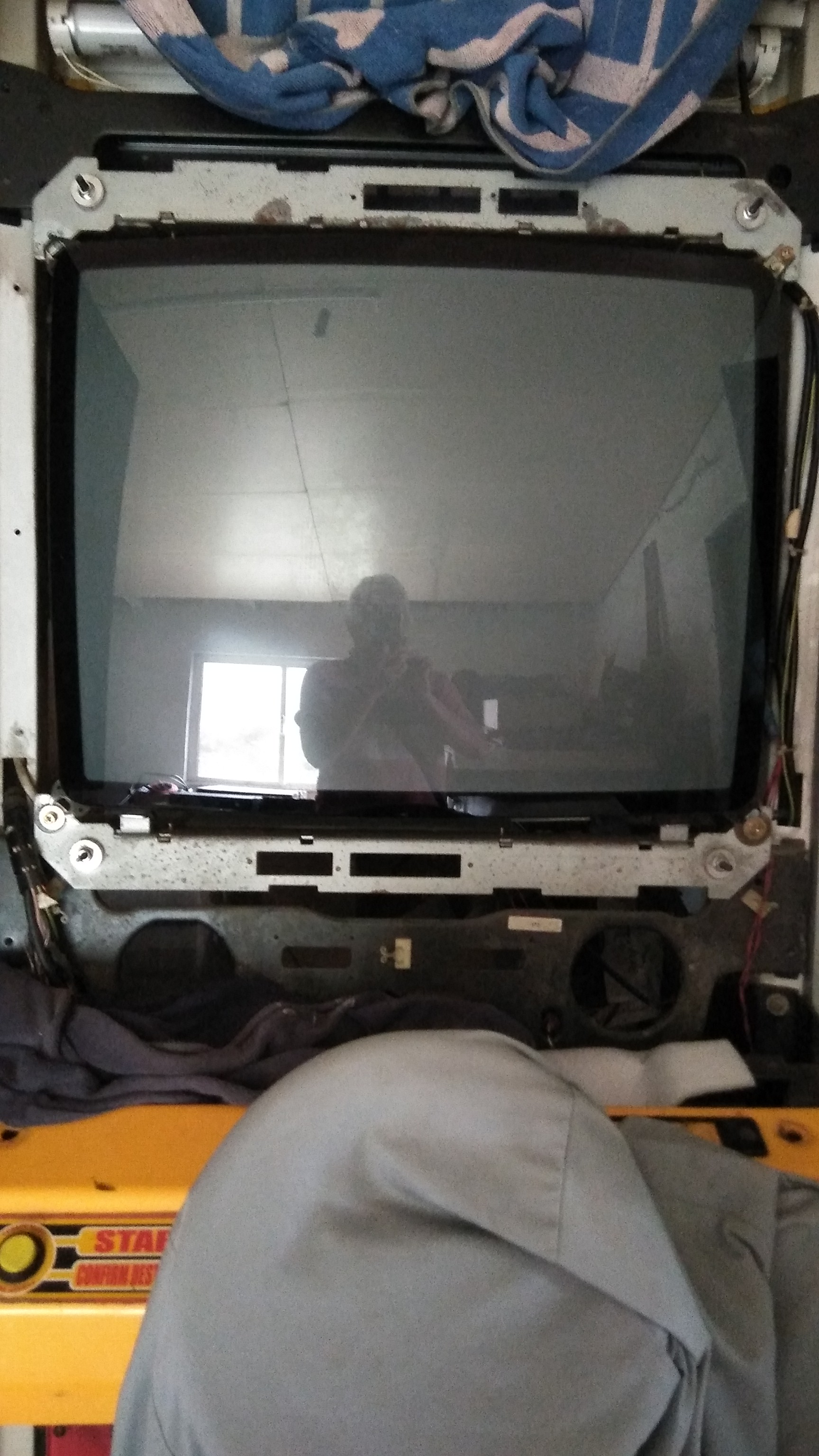

Man so that is how you are supposed to mount it in a Naomi Universal.
I tried swapping it into the original SEGA frame but even back mounted and with a fair few spacers couldn't get it to sit inside correctly and also had the problem of not being able to properly mount the chassis...
How bad is the gap doing this and which mask are you using?
Ended up reverting back to my original 31khz only chassis and recapping/servicing the chassis but maybe that was for the best because sadly the chassis on my Walls Gardner gone and died on me after barely a months worth of external use.
Need to look into that properly sometime to see if I can repair it. A resistor blew off the neck PCB when it went and don't think I have a value for it.

Yeh no spacers needed at all with the frame mounting.
I have the semi curved mask
That goes with the SanwA 29e31s so there are little curve gaps
But if you could get the true flat mask / monitor bezel
I would expect it to fit perfect!
