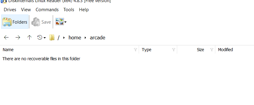

I have tried using a Windows pc running linux reader but that simply does not show the same files as you see when doing it from the USB stick in the arcade set up !
