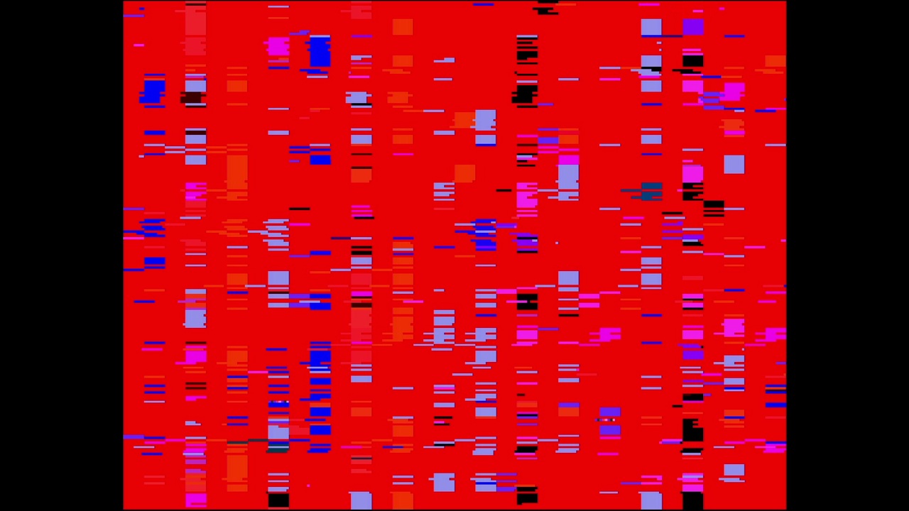

The GX400's synthesized voice (VLM5030) performs a bubble memory warm-up countdown before the numerical countdown. (The visuals displayed here vary per video, but this is to transfer and initialize game data to the main board after warm-up. There is a theory that the visuals were caused by uninitialized VRAM.)

(After warm-up countdown ends)
A crackling white noise sound occurs,
the warm-up countdown voice interrupts, the VRAM display initializes, and switches to a numerical countdown.
