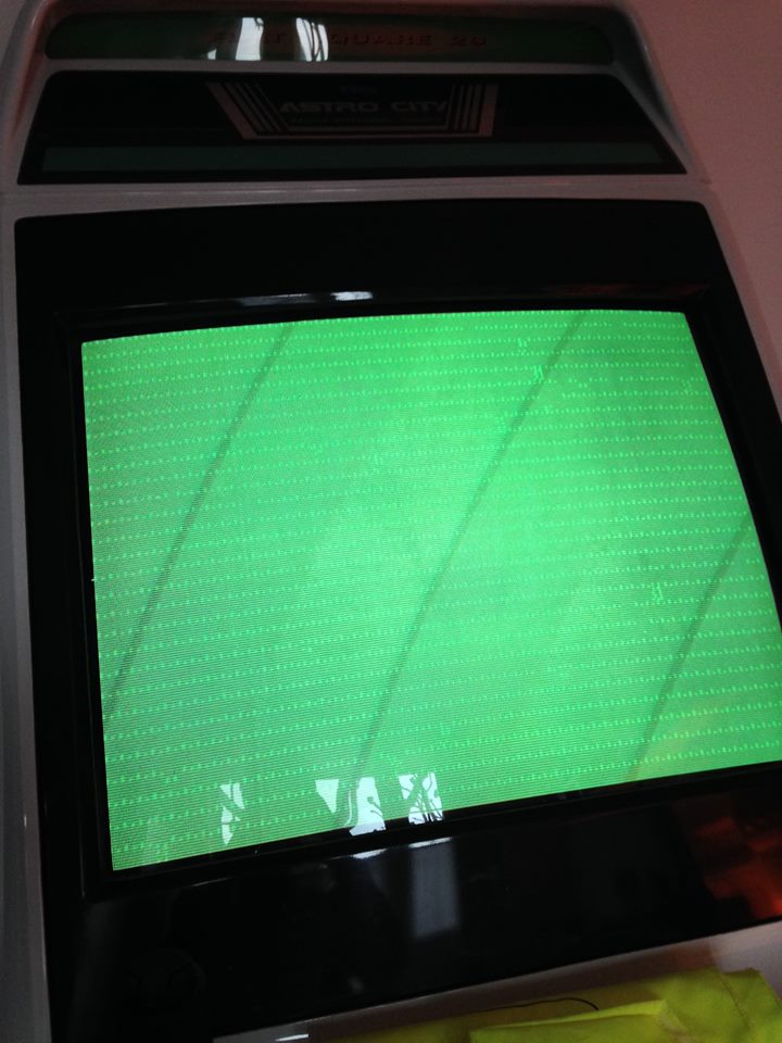

When I fired it up without a cart I got to the system menu. Putting a game in led to a green screen every time:

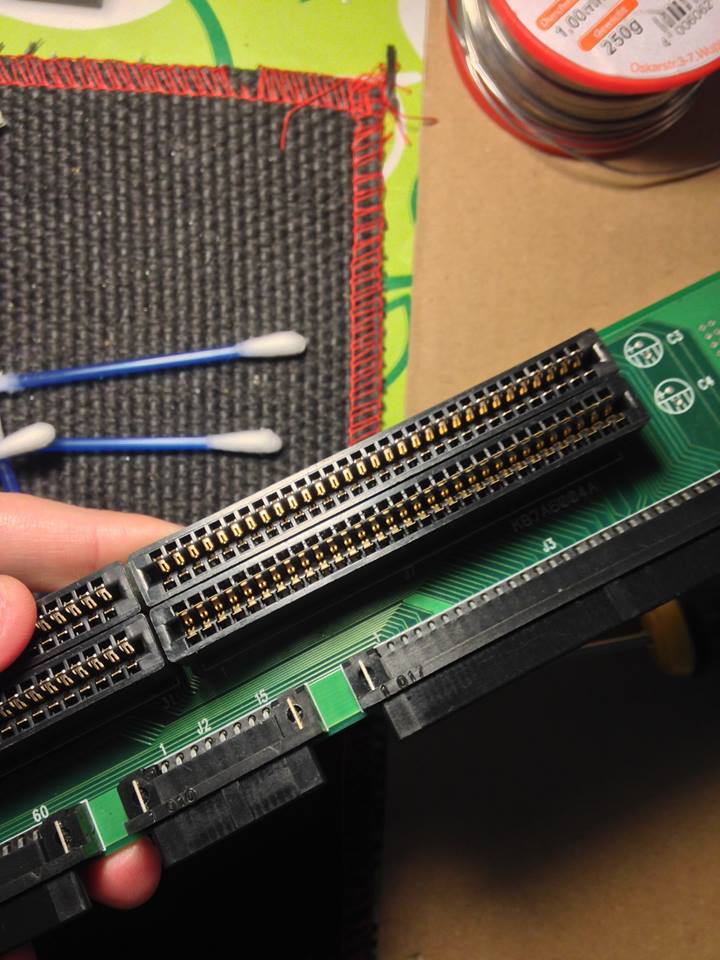

There's a badly broken trace running from JP1 to a via near the 3P+4P connector. I left that for the time being and instead went to the other visual fault which was with the daughterboard:
One pin missing and another next to it a bit wobbly.

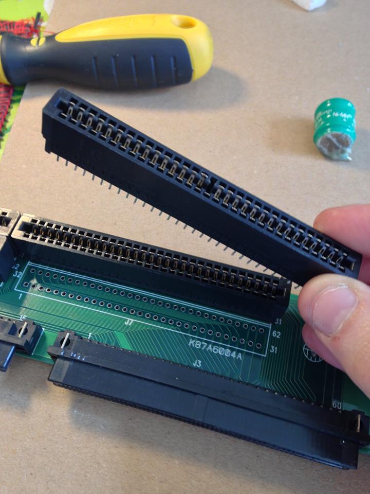

Thanks to my Hakko I was able to make short work of removing the connector:

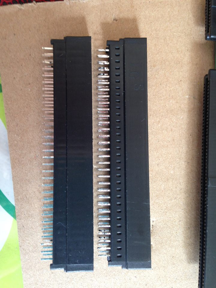

The part is a 62pin edge connector with IGS branding on it. I initially thought I would have a tough time replacing it but I managed to find a matching part from Taiwan via eBay.
On the left is the replacement and on the right is the original (you might be able to faintly see the IGS logo):
For anyone interested, here's the eBay link.
Much better.

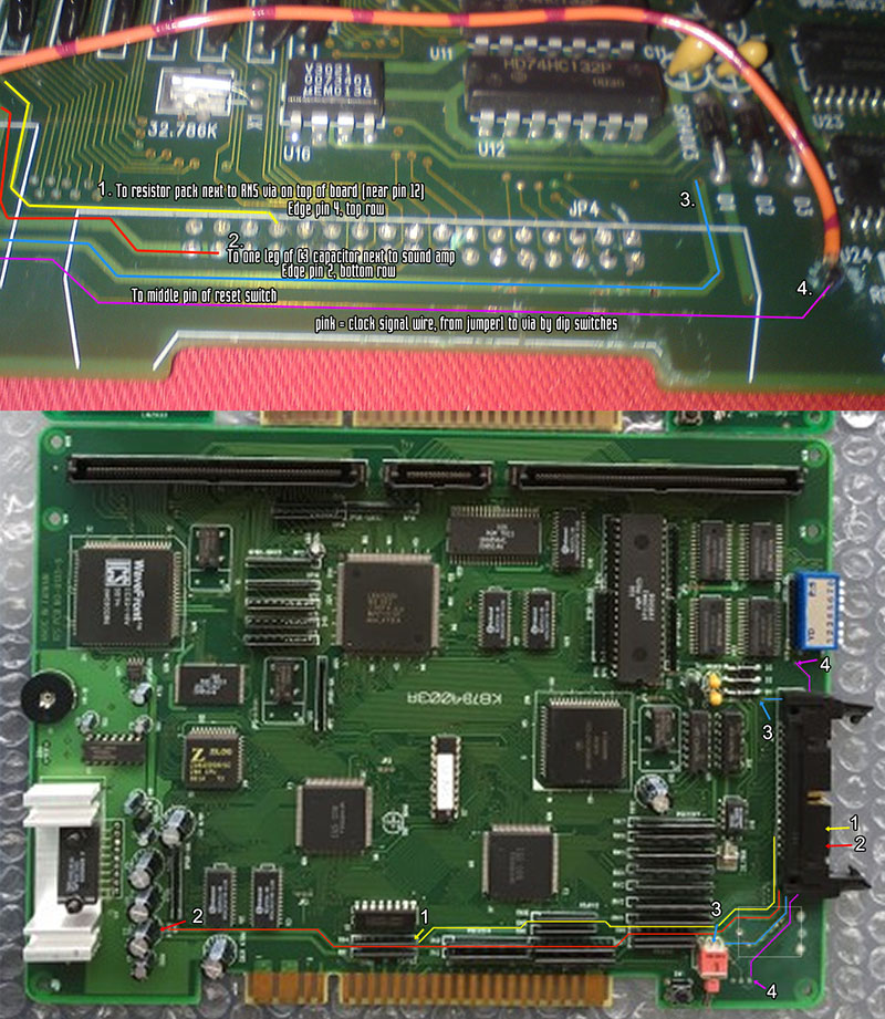

Hi Darth, I have a board with the same issue here (green screen noboot), you wouldn't still have a copy of the missing photos above with the battery removed would you? I'm trying to work out where the two thicker traces go from the reset switch + resistor pack that are also under the battery. They seem to go somewhere under the 3+4 player expansion connector :(
Flinnster
The Dino King
29 (100%)
2,566CR
Found something on that youtube link I think.. bit sketchy up towards the top though.
The first thick trace nearest the reset switch at the bottom goes to the via next to the D1 diode at the top.
The second thick trace (badly eaten away on mine) goes to one of the edge connector pins for players 3/4 stuff I think.
Flinnster
The Dino King
29 (100%)
2,566CR
OK figured it out. Posting up some images here, in case it helps folk in future:
(One fully working PGM motherboard here, photos shown are not of my board though)
