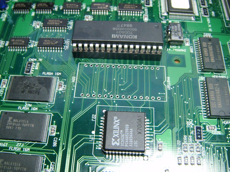

Here is the 573 PCB and the chip in question is under the insulation tape.
Exposed now. The problem with this thing is that it is flush to the PCB meaning access to the pins is only available from the solder side.I prefer to just cut suspect chips out (if they're not customs), happy to destroy them than do anything to the board trying to get them out. Trying to remove chips from certain PCBs can be a problem particularly on multi-layer PCBs - just like this one in fact.

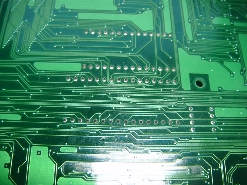

Solder side of the board with 28 pins to de-solder.
I use maximum heat on the iron and use of plenty of flux. I have a solda-pult sucker but using it on this multi-layer is a complete was of time. Prime the pins. Heat the solder and mix with flux. I do this about 5 times. I then use de-solder braid to get remove the solder from the pins. It was a bit touch and go on three pins.
The three pins are numbers pin 26 for some reason and pins 14 & 28 which I assume must be GND and +5V since these were a bitch to clear. The braid causes a little scorching to the PCB but nothing noticeable. I find it the best way for me (on these multi-layer boards).

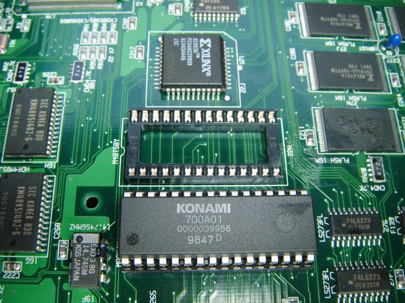

Here is the chip in question, now out.
Here is a socket in its place.
It's fairly neat on the solder side.
I've ordered a replacement for the far east for £4 delivered (it's amazing how things can get across the other side of the world for those prices, but I'm not complaining). Put the existing SRAM back in until the replacement arrives. Put everything back together and it's all good.

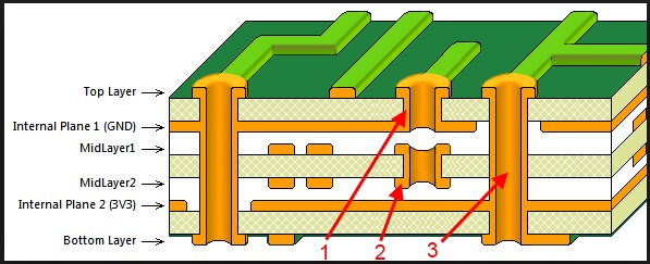

Multi-layer PCBs are a pain. Before doing this I did some research and discovered that Craig has seen a lot of these sent in after people have had a go at them.
The multi-layer is the problem. I'm guessing that when you apply heat to the pins attached to the internal core layers the layer takes most of the heat away. I also find the solder has sort of fused or oxidised inside the eye. I can see why a lot of these end up being damaged.

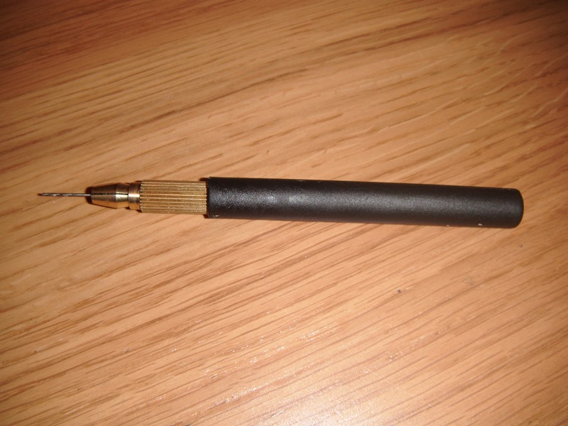

One thing I forgot to mention - if you do end up with a soldering eye where the solder just won't come out I tend to drill the solder out very carefully. I use what can only be described as a 'pen drill' to remove it. I used this on those three pins. If you go at the pins with the iron for too long it ends up screwing the PCB up. Too much heat tends to kill things. I used this drill on all three stuck pins. I was fortunate to get the chip out by gently prying it (by hand and finger force) from corner to corner (no screw driver or you'll bugger up the PCB once again).
This little gem gets me out of all sorts of scrapes when there is stuck solder in the soldering eyes but you need to patient and careful when using it.
