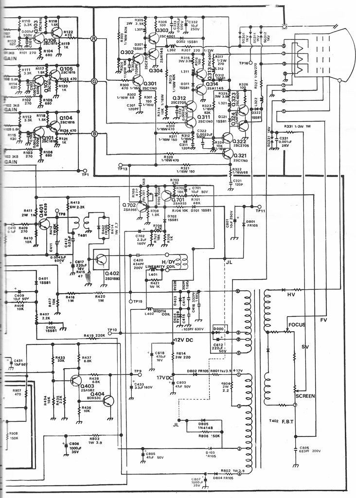

I have a horizontal collapse issue (vertical line on screen) on this monitor. I’ve dealt with vertical collapse many times, but this is the first of these I’ve ever had.
I can’t seem to find a schematic for this chassis - so any help would be appreciated. I’ve checked for dry joints, and the width coil isn’t damaged. I was going to re-cap the monitor, but any tips would be great.

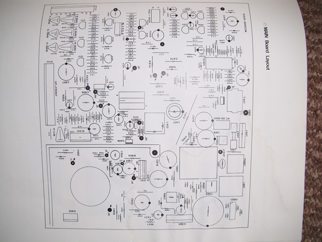

That is my manual, I have just taken snap shots of it. I could do a full scan for you (I’m busy) but in the interim I’ll post some more photos for you

I recently got a cab with a KORTEK KTM-F20 chassis in it, and while I've found several scanned manuals of very similar models, they don't match exactly. Especially in the "main board layout" section, it's way different on all PDF's I've found so far. But this one seems to match 100%.
