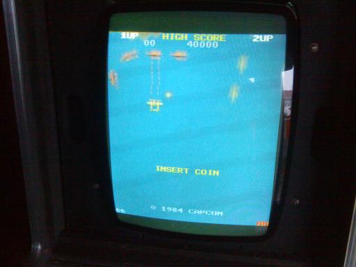

My Monitor started with problems a couple of years back which i just ignored like you do :) Hissing, Crackling, Stripes through the screen and light on one side dark on the other.
I took it out of the cab a few months back to finally have a quick look and this is what i found
Basically did a temporary fix, Cleaned it moved the position of the anode cap so the damaged rubber part was sat on the good bit of the corona and covered it in silicone grease. I also changed C502 which was leaking and causing the stripes and also light dark issue, Banged it back in the cab and carried on using it. The monitor pretty much worked fine apart from a dark shadow would move across the screen after it had been on for a while.
I've just taken it out this last week to sort it properly, Full recap, New flyback, New Hot and a lick of HV varnish over the anode area so looking a bit better now (also realized i can't paint for sh*t!)
Half way through the recap i checked it and the Horizontal size had shrunk a little?? but didn't think much of it until I'd finished and had to adjust it, Horiz width adjustment near the flyback doesn't work at all so at some point will have to look at that next time it's out
Nice boarders Hmmm... Other than the lack of Horiz adjustment it's working a treat, the picture has improved and no more crazy noises. I know alot of people hate these korteks but they not too bad really as a cheap alternative to Hantys.
