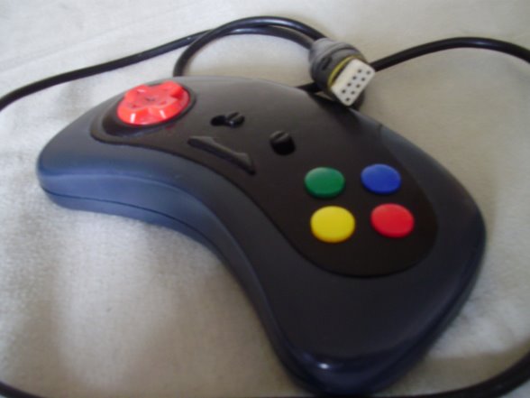

there's only a few vectrex games which use the original vectrex controller in an 'analog' way, most of the games use it as if it was a digital stick, so you can just hack any basic digital gamepad and play almost everything available (when you push a direction on the D-PAD it just registers as that direction being fully on).
i made one a while back; i used a quickshot gamepad bought off ebay cheap, works great:
