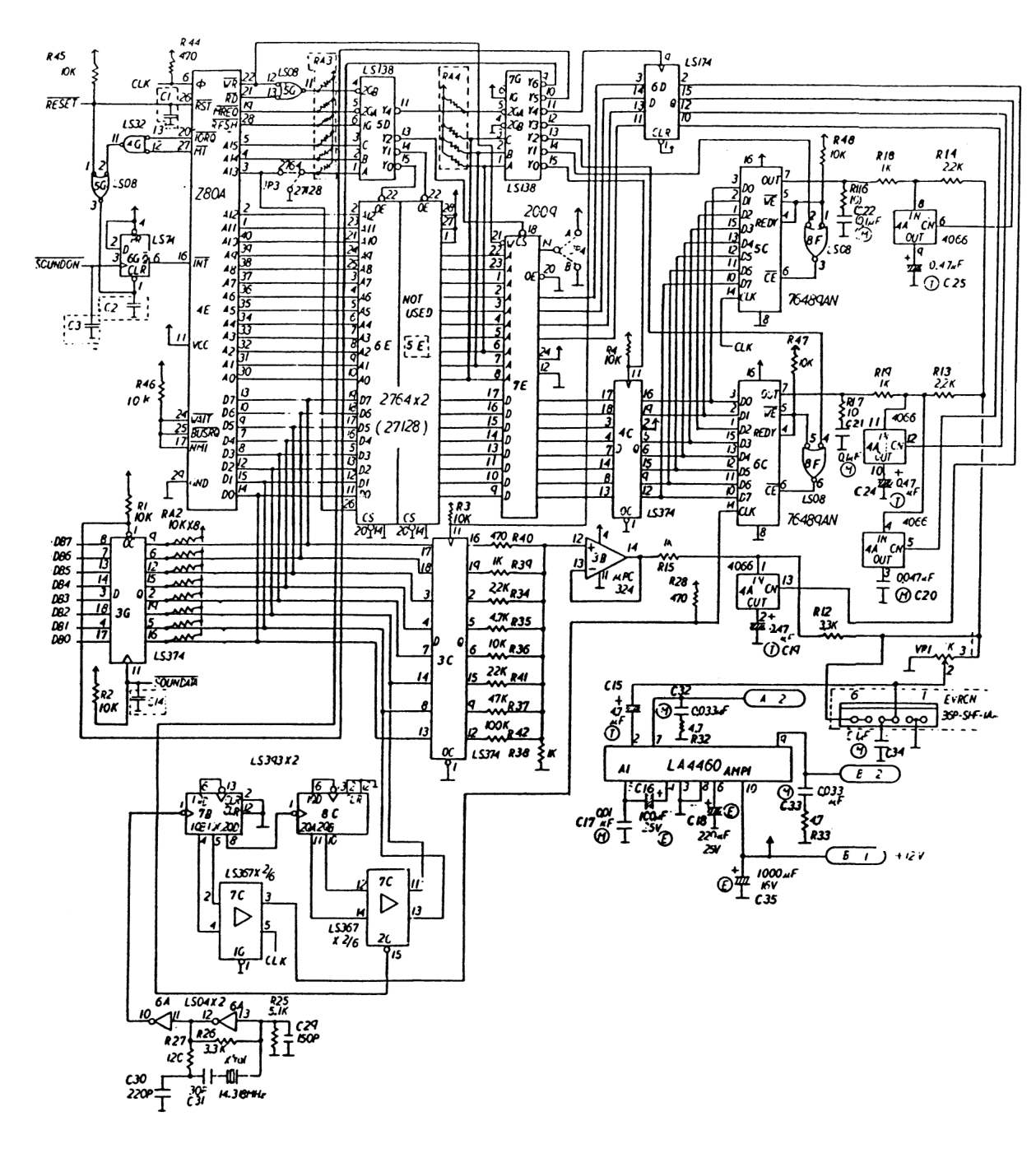

Sound;
Amp was dead (finger test) replaced it and got speaker hum but no sounds. The Z80 at 4E is the sound CPU and was getting clock signal and reset pulse at boot but did nothing. Suspected it was dead so replaced it and some sound returned but some random sounds were playing and the music was missing. Suspected the 6116 RAM at 7E so pulled it and it failed. Replacing it restored the sound properly.
