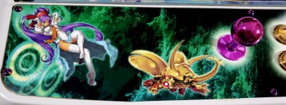

About a month ago, I managed to get my hands on my first CAVE PCB: Mushihimesama Futari, along with a single-player CPO for my NAC cabinet. Naturally, I immediately knew I wanted to create a Mushi-inspired CPO. As luck would have it, I have some very talented friends when it comes to working with images.

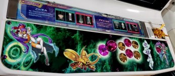

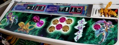

I reached out to my friend Doug Blake and we traded skills—he helped me with the design in exchange for some 3D-printed models for his tabletop games. The result of our collaboration is what you see in the images.
For the stick, I modified a Seimitsu LS-32 to fit a blued titanium Sanwa stick rod. I did this by designing and 3D-printing a sleeve to match the diameter of the rod with the stock Seimitsu one. Additionally, I shortened the stock actuator to properly fit the new rod, allowing for fine-tuning with small shims.
For the CPO screws, I wanted the same blued titanium look as the rod, so I used blued titanium bike disc brake screws. When it came to selecting the buttons, I went with metallic Sanwa buttons in a color scheme that complemented the CPO design. This theme continued with a clear rod sleeve and a custom 3D-printed dust washer to match the ball top.
