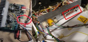

Hi all, wonder if you can help me.
So I'm missing this AUDIO wire which I believe goes into the PCB located in the control panel section.
I also think in the past I have has one of these leads just directly soldered to a pot so I can control the sound, but could been wrong.
Either way, does anyone know the names/part no's for these parts if I'm correct in guessing this is how it works, also does anyone have one for sale or know somewhere that may?
Thanks in advance.

Hi whitecomet,
I don't have any part numbers to help or names for the cables, but i hope it helps you further (you need a little imagination to find this out, sorry about that 😇)
The connection in your first post picture is correct ( wire colors are different tough for my machine ) and the wires travel to a 9 pin JST H ( 3,4 and 5 pins on the connector ) connector on the far right side of the pcb board pictured in your second picture, follow that 9 pin connector cable to the left in the housing and you should probably find the other side of the connector, it's converted to 3 pin connector on it's way (in my machine) to the colours are : red/white, green red, white red.
Connect your cable from the audio board to it and you can control your sound on the pcb front (the black pot meter knob on the right ) no need for soldering if no-one cuts the original cables before 😉
