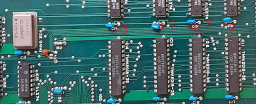

I trying to fix Hammerin' Harry M84-A-C with Graphic glitches.
Test give bad ram NG 9 .
Where is location this chip.
Thank you :)

i check these IC11, IC12, IC13, IC14 on all 4 chips the address bus is stuck to low and tracked her down to this skinned custom chip 64pin.

Did you lift the pin at the custom to make sure it's not one of the rams pulling it low? It most likely is the custom though I've seen a few bad GA22 customs already. :cry:

Тhe case is solved...
unfortunately it turned out to be true that the custom chip is damaged.
After removing rams and testing them, they all work.
I removed and customized the chip ... after elementary measurements between legs his no gave resistance anywhere .
Can such a chip (i think is Nanao KNA70H015(11) ) be found anywhere?
