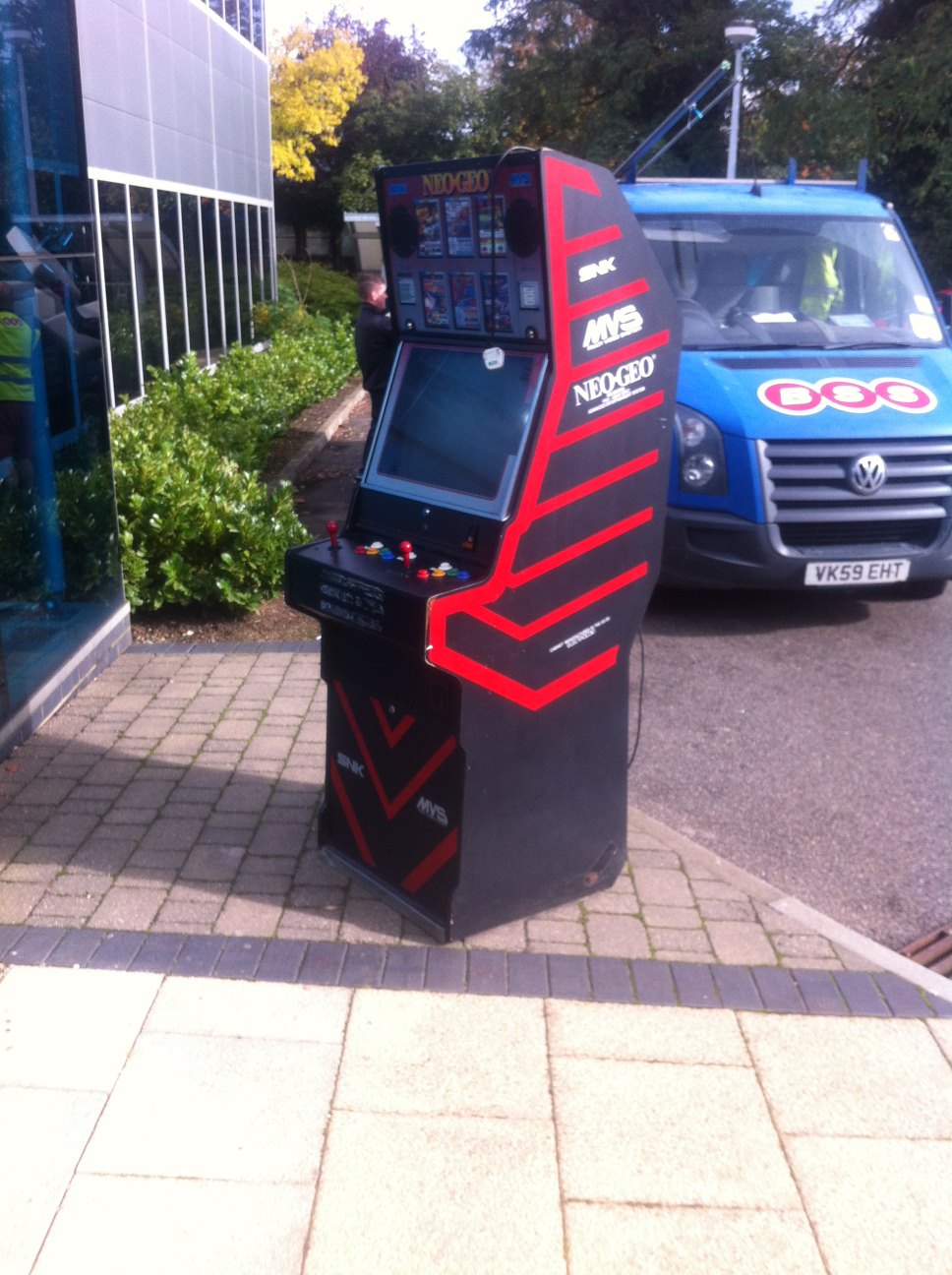

Lat year I was given an Electrocoin Neo Geo 6 Slot cab by my workplace who were having a clear out. Until just recently the cab has been at the back of my garage behind loads of junk, a garden shed etc.
but now after a good clear out and finally putting the shed up I have plenty of space in the garage again and the cab is indoors.
I was a bit wary when I saw the size of the cab, as it's very tall and has a big vertically mounted monitor so I was pleasantly surprised to find it's no bigger than any of the other cabs I have, only taller.
It's actually shallower than the other cabs and even though its got a wide monitor it's pretty much the same as the others.

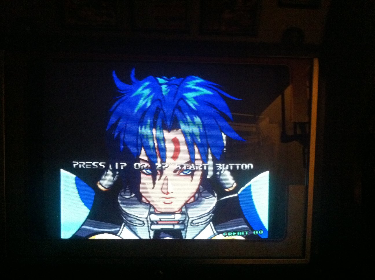

I stuck one cartridge in, switched the three! interlocks and powered up.

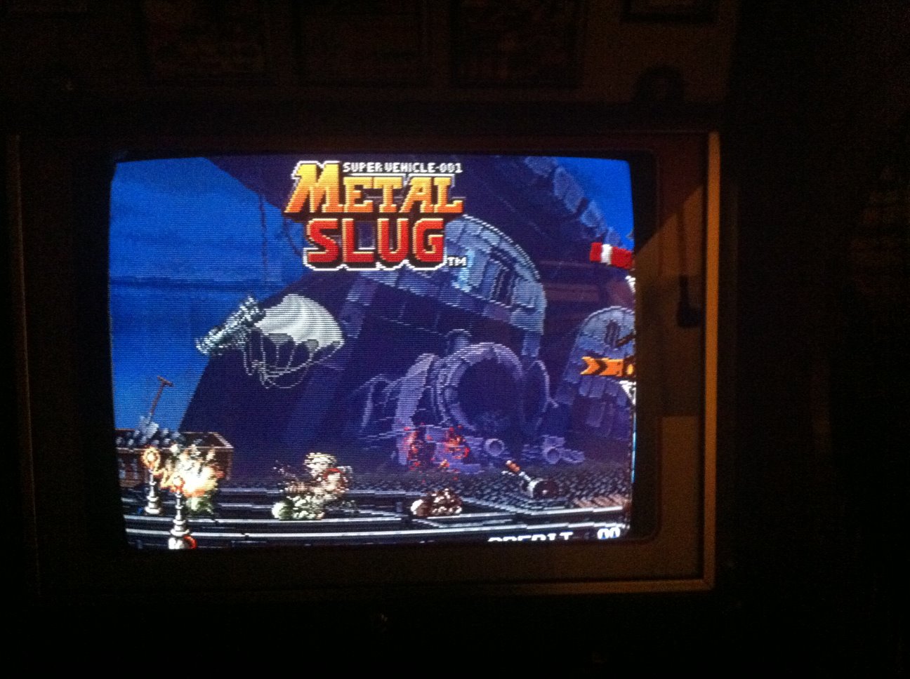

The fan on the monitor started to life and I heard the crackle of static from the monitor so checked round the front...
To my joy I saw the familiar boot up screen then the metal slug attract screen!
There was no sound and none of the lights or the credit display work, but the monitor image is fantastic - nice and sharp, great geometry and spot on colours.

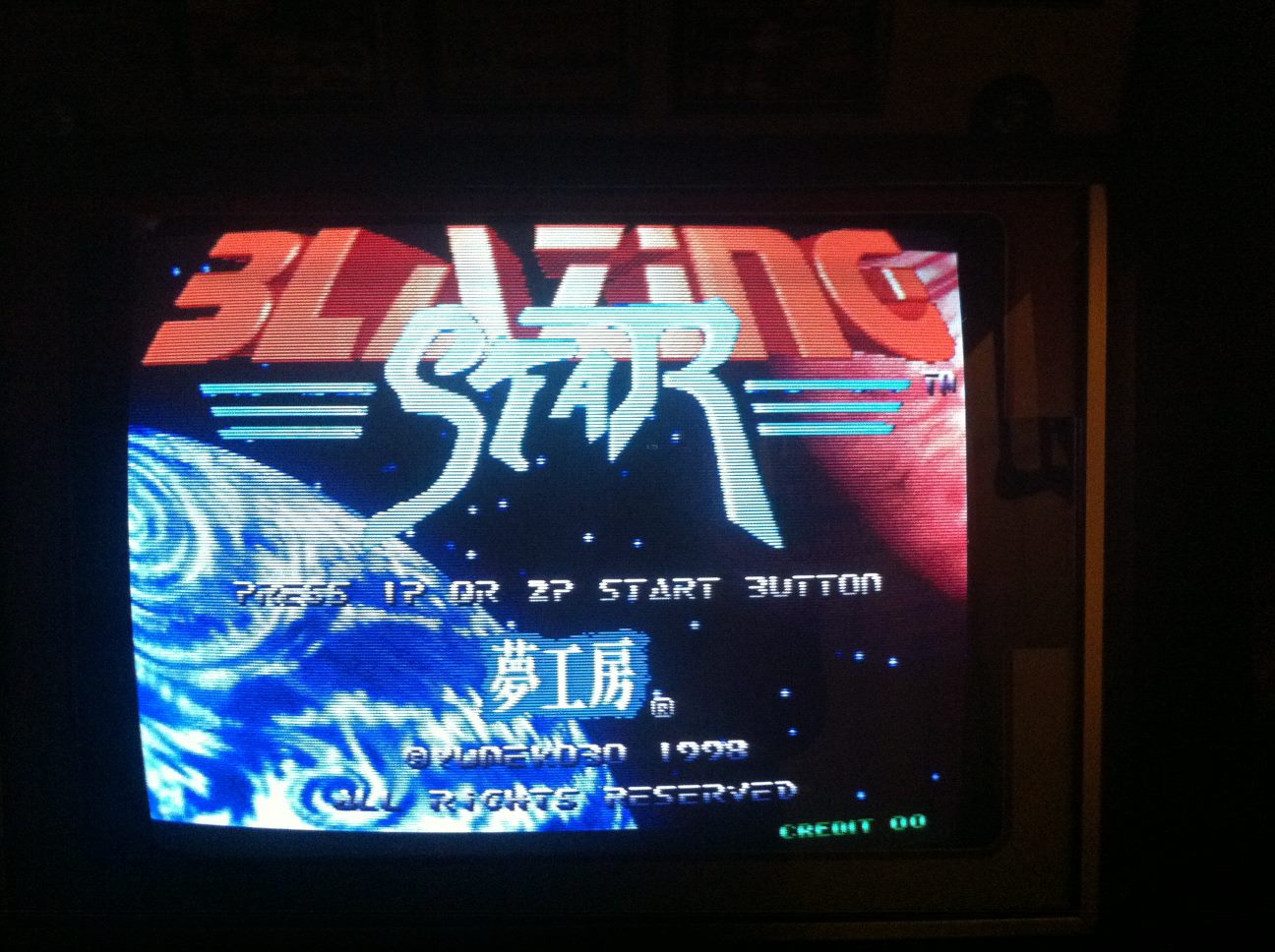

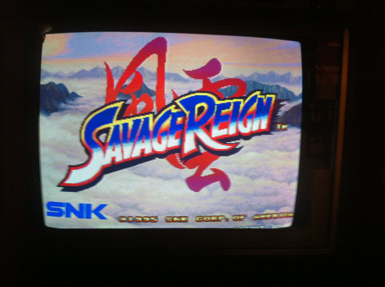

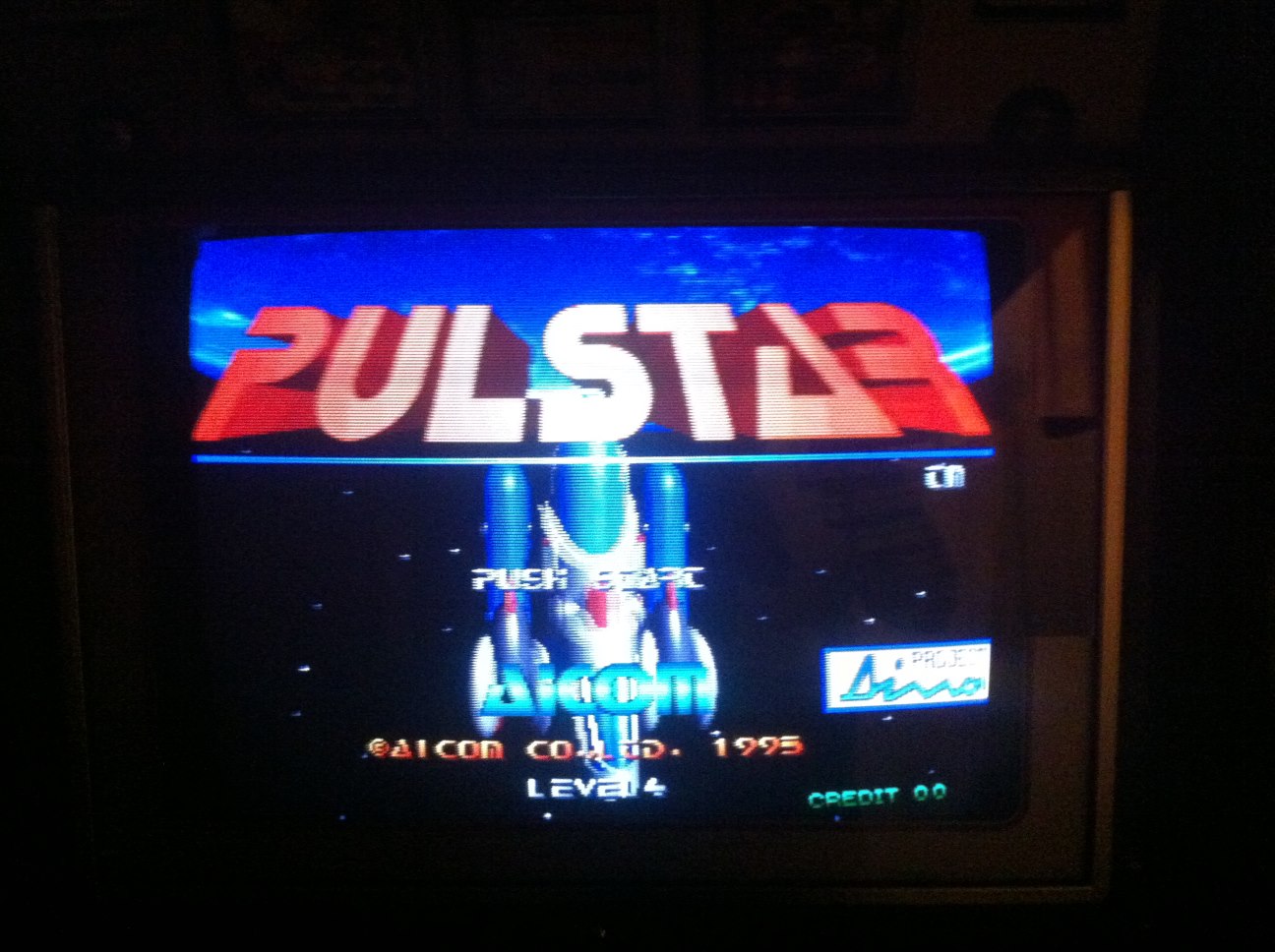

I decided to try the different slots and after various combinations, wiping the connections on the cartridges & jiggling them in the slots all 6 games worked!
