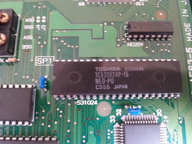

4) Locate the original Bios chip

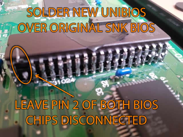

5) Cut Pin 2 of the original bios

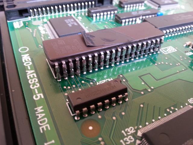

6) Lift Pin 2 of the unibios and place over the top of the original bios
7) Solder the 39 remaining legs of the unibios to the legs of the original bios - gently apply some solder at the bottom and drag your iron to the top

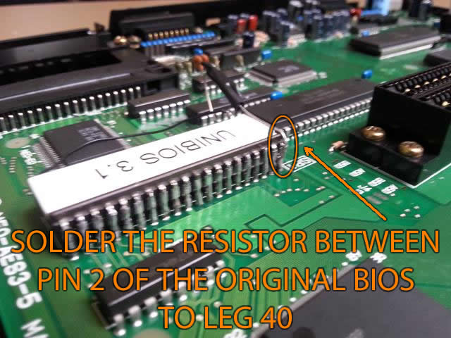

8) Solder a wire from pin 2 of the unibios (top chip) to Leg 20
9) Solder the resistor from pin 2 of the original bios to Leg 40

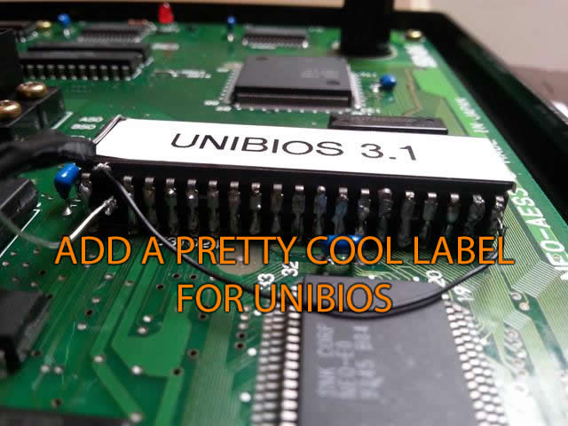

10) Reassemble console and test it works

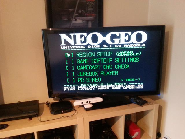

Phew! - it worked, the game booted up perfectly, get in!
turned it off and changed the game, turned it back on and........i got a load of garbled graphics, the usual type of thing i have seen when working on MVS boards that have got issues!
so swapped back to the game that worked previously and it did the same with the garbled graphics - hmmmm
so i went back and tested each leg with my continuity tester, a few of them were not showing a good connection so i went back and re-soldered those legs, re-checked with my tester and they were all showing ok, turned it on and it was working properly, swapped to a few different carts and all was working great!
