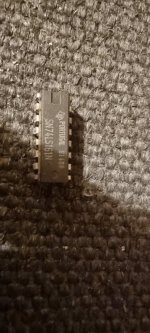

sukhbir
46 (100%)
1,732CR
Thanks for sending the picture,as I suspected it’s a Texas instrument.over the years of fixing arcade pcbs I’ve come across a lot of failing 74ls161 TI’s not to mention those nasty Fujitsu logic chips.
