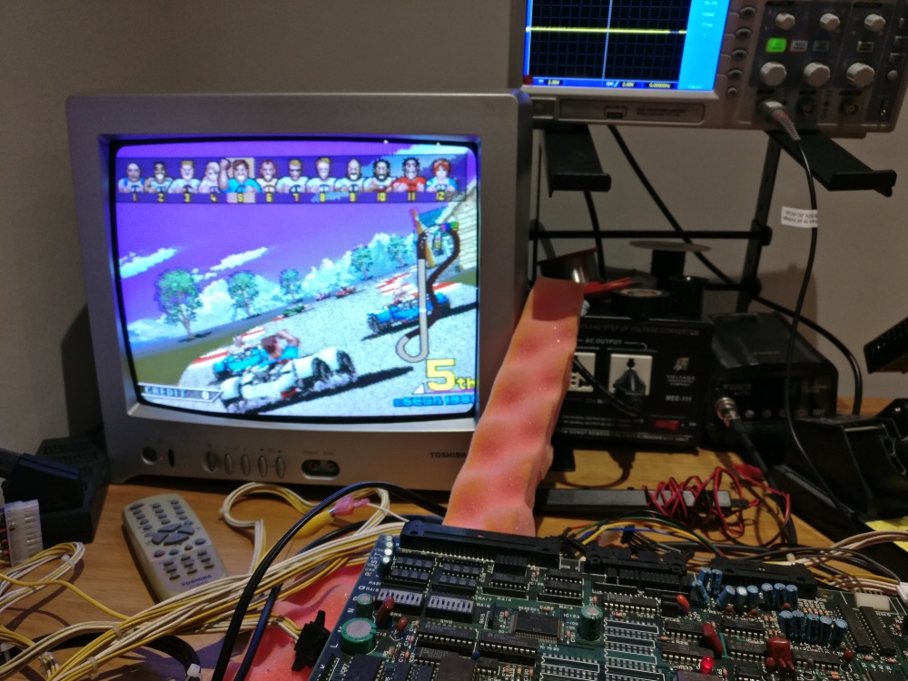

I'd accumulated 3 broken or untested Power Drift PCBs. All three completely black-screened and showed no signs of life. I decided it was time to try to get at least one of them working. They are difficult boards to find working and I've always fancied playing the game in my OutRun cab.
The Y-Board is complicated, using 3 68k processors, a z80 for sound and loads of custom chips. So when faced with a dead board, there are a lot of potential candidates. Using the scope, I could see the main 68K CPU was resetting every few seconds. There seemed to be good activity on the data and address lines however.
I tested the Main CPU EPROMs first and they all seemed to be bad?! To be honest, I don't know how much I trust the GQ-4X with 27C1000 EPROMs.... it seems inconsistent. But anyway, all the NEC D27C1000 branded ones failed romident. I programmed some new ones, and pinched a few others from one of the other spare PCBs.
The board then booted into life, but with lots of graphical corruption. Amazing - I've never had such an easy fix before. However, the game completely crashed after a short period of time.
Using the scope again I could see that the 'Sub X' CPU (Mame driver naming) had no activity on the data or address bus. The 'Sub Y' CPU seemed to be behaving sensibly. At this point I replaced ALL the NEC branding EPROMs for both CPUs.
The game then ran consistently without crashing, however there were occasional graphical errors.
I swapped the lower video PCB out with one of the other spares and this solved the remaining graphical issues. Unfortunately it was quite late at this point and I forgot to take photos of my progress.
So there you go - not really the most technical fix-log ever. But a fix is a fix, and I'll have a poke around the remaining 2 PCBs next. I also need to hook up some controls.
