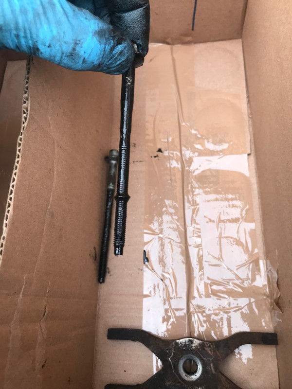

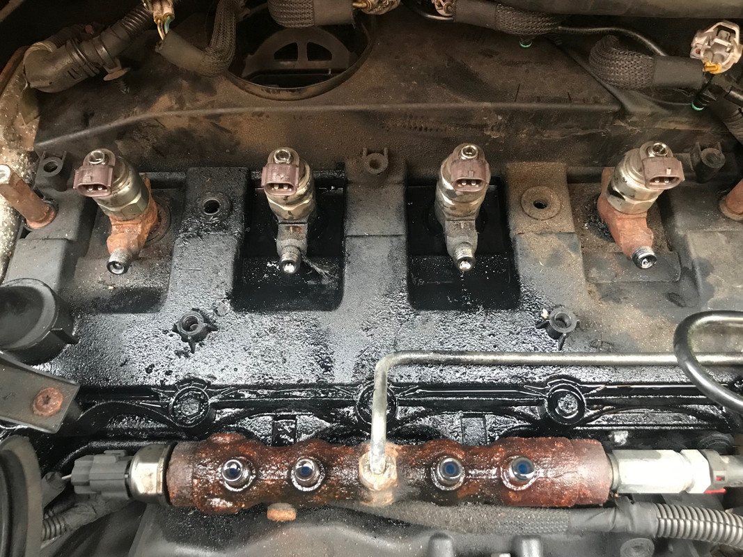

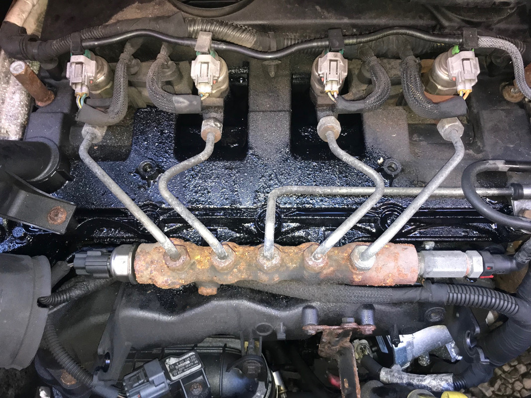

nearly got them out to have a look at them, they are supposed to be a push fit but there quite stiff to get out, any ideas on how to remove them without damaging anything?
also quite oily around injector 3 and 4

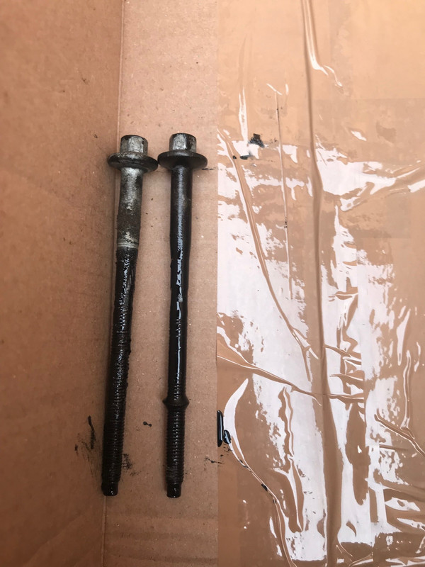

need 2 new clamp bolts too
prof5
50CR
When I have had stuck injectors I undo the clamp bolt a couple of turns the run the engine, as it warms up it usually pops the injector up the clamp, they get stuck when the seals start leaking and burnt carbon gets up the side of the injector.
prof5
50CR
The oil looks like it is coming from around the injectors, if so does the smoking get better after the first start of the day, if it does then it is probably valve seals leaking, if the smoking stays the same all the time it is probably oil control rings on the pistons
jengineer
47 (100%)
1,164CR
cheers prof,
from a cold start the smoking is not noticable from my wing mirrors, after a good 10 minutes it gets worse, especially around 2000 revs and going uphill, on a flat straight at 60 i can't see any smoke
also definitely lost power going uphill etc
