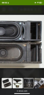

After much clicking around, I found a speaker which is 1mm less wide and 8mm shorter, whilst still being 4Ω.
May I present to you the SOTAMIA 2Pcs Rectangle Speaker 4 Ohm 10W Full Range Speaker Bass Rubber Side Neodymium Magnetic Hifi Loudspeaker Home Theater
They come in pairs, so I needed two pairs. Here are some comparison photos:

  • Fit the new speakers, ensuring they meet at the centre, as shown below. Secure with two screws per speaker.
  • Buzz 2.5mm holes through the remaining speaker mounting holes. Fit screws to the remaining holes. It's not a perfect solution, but I believe it to be good enough.
  • Reassemble the side panel and screw in place.
  • Glue the little rectangles into place in order to cover the gaps.
