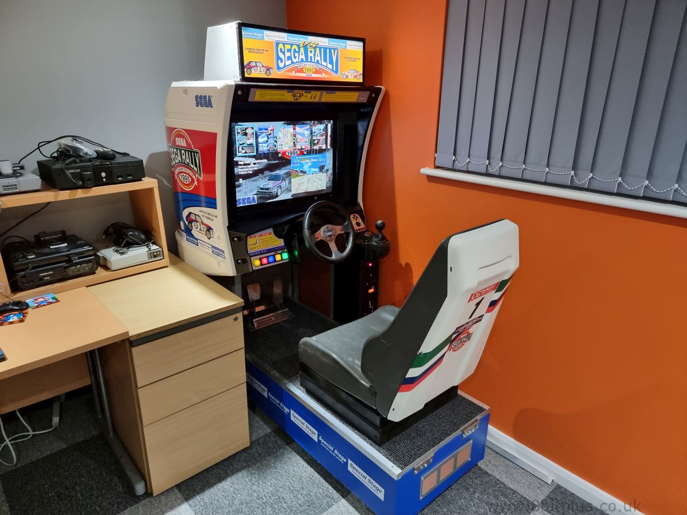

I've been working on this for most of the year, now its more or less finished. I always wanted a sit down driving arcade cabinet and decided to build one now I have the space.
I've tried to integrate as many real arcade parts as possible. Seat, sides, dash, bezel, and pedals are all used arcade parts.
lots more photos and info on how I built it: click here.
Its my first time building something quite like this, so let me know what you think.

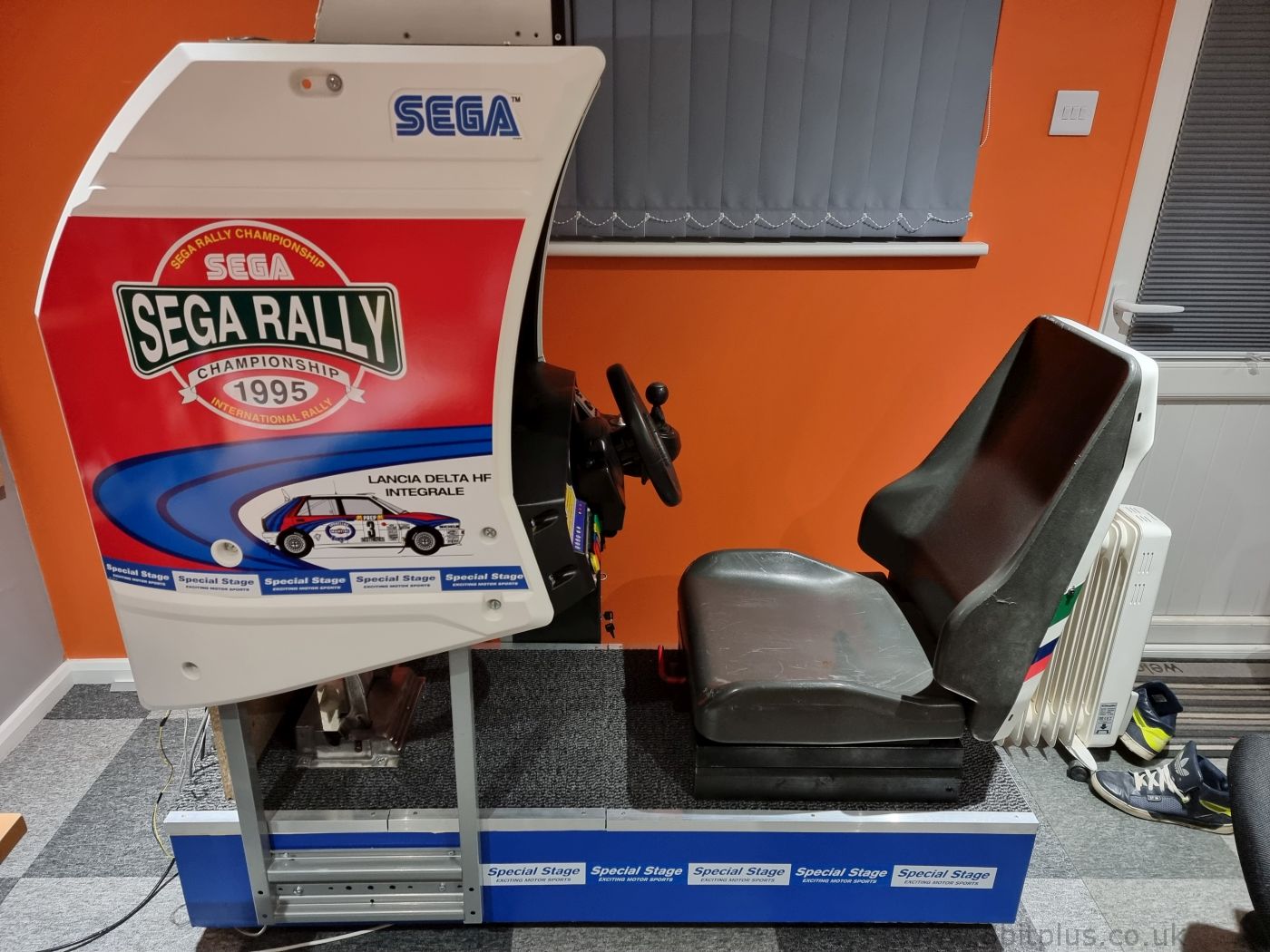

Thanks. I saw plenty of examples online of what I didn't want my build to look like lol
The only thing I think I need is the different shaped seat back plastic. Mine is more line a Daytona Seat, in fact it had the "Road Burning Action" decals when I picked it up.
If anyone has one please let me know

I might have one, but I'm not sure what condition it's in. I've got to get out to the container to get some promiaed scans of an Electrocoin MVS bezel, so I'll take a look at the same time.
tt_rage
76CR
Ah, it's a Sega Rally 2 seat back. It's cream in colour, so I don't know if it'll fit your needs. And there's a crack in the top of the shell, but that could just be a superglue job.
Let me know if you want it and we can figure out how to get it to you.
